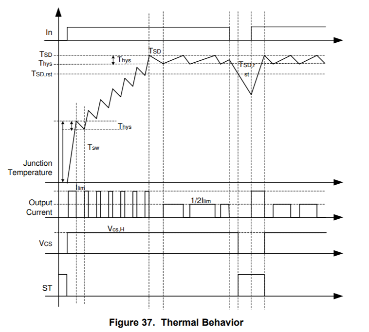

    If the overload detection function does not work, thermal shutdown operates.
    Please tell me the maximum current value at before thermal shutdown operates.(Assuming overload detection not working)
    Or is there a waveform from overload detection to thermal shutdown? If there is, I want it.
    Ishiwata
  • Ishiwata-san,
    If the set external current limit is incorrectly configured or there is a break in the resistor connection to ground the device's internal current limit will be defaulted to. This is specified by Ilim,nom in the datasheet and for the TPS1H100-Q1 has a minimum of 7A and a maximum of 13A. This would be the max current limit that the device is possible of regulating to regardless of the state of the CL pin. If the internal and external current limit are not regulating then the device is not operating correctly and cannot be considered reliable.
    One statement I wanted to correct you on is, "If the overload detection function does not work, thermal shutdown operates.". This is not entirely true. The current limit will regulate correctly to the set current limit and go into thermal shutdown if the device is functioning correctly. This is the case with having a short-to-ground scenario or setting the current limit too high and trying to charge a load capacitance that is too big. The current limit is hit, the TPS1H100-Q1 regulates to the set current limit, the junction temperature of the internal FET heats to the thermal shutdown temperature, and then the device shuts off. I would recommend referring to the driving loads application note (https://www.ti.com/lit/slvae30The behavior can be seen in the following figure from the TPS1H100-Q1 datasheet:
    Once the device cools to under the thermal shutdown reset temperature the device will retry with a 50% current limit set. I don't have any oscilloscope shots for the TPS1H100-Q1 specifically for the thermal shutdown, however see below a few screenshots for the similar TPS4H160-Q1. Note for the TPS4H160-Q1 the current limit goes to 70% after retrying from thermal shutdown versus the TPS1H100-Q1's 50%.

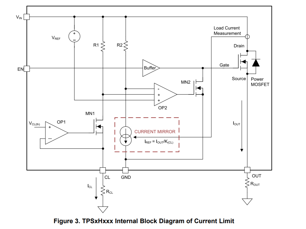

    Which is control for the current limit, logic circuit or analog circuit?
    Ishiwata

  • Hello Ishiwata-san,
    The current limit circuitry uses an analog current mirror with a comparator to determine if the current limit has tripped. This is described in detail in the 3.1 Basic Implementation for TPSxHxxx Devices section of the following application note:
    https://www.ti.com/lit/slva859
    Specifically this diagram will be of some interest on how the current limit operates on the TPS1H100:
