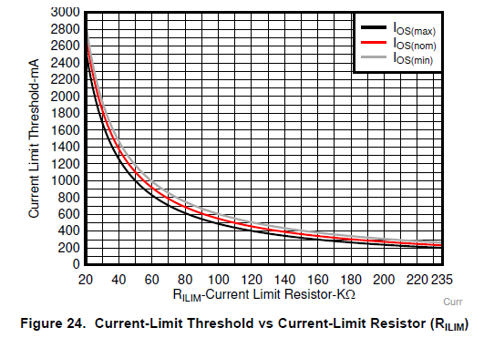

Hi expert
Is the description of IOS(max) and IOS(min) in datasheet Figure 24 typo?
If yes, do you have any plan for datasheet update?

Hi Muk,
Correct. It 's a typo.
Will update it to team and modify this.
Thanks for pointing out.
