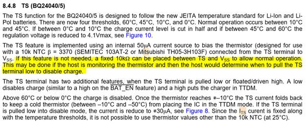

Hi Sir,
Pls kindly advise how to connect TS (charger is enable) if I don't want using bq24040 TS to detect?
And how to connect TS if charger is disable?
Thanks, Ian.

Hi Ian,
BQ24040 will be enabled with a fixed 10k resistor to ground. To disable pull TS to GND with MCU.
Hi Nick,
Pls advise if bq24040 can meet customer's condition as below?
0~10 dergree C(JEITA reduce current)
10~45 degree C(Normal)
45 degree C (STOP charge)
Thanks, Ian.
Hi Ian,
Possible with an MCU, see this thread here where I have discussed this:
