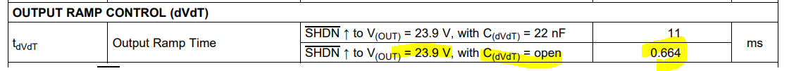

  • Hi Takashi,
    The device recovers from OVP if the Vin voltage falls below the set OVP falling threshold. While recovering from OVP, there is no dv/dt mode of operation. The device ramps the vout voltage similar to the case Cdvdt=OPEN. Ramps the Vout at the rate of 23.9V/0.664ms.

  • Hi Takashi-san,
    The devices are designed to support quick Vout recovery from transient Vin voltages to serve the load with minimum interruption. If dv/dt mode of operation is needed, the customer can reset the SHDNb pin.
