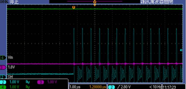

My customer had build 25 pcs of PCB and saw 10 pcs got issue that the output switch pin stop switching shortly (issue happen at SW_B0,B1,B2,B3 rendomly).
Below is the waveform we captured, any idea what might happen here ?

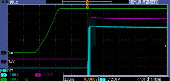

Zoom In the above waveform as below

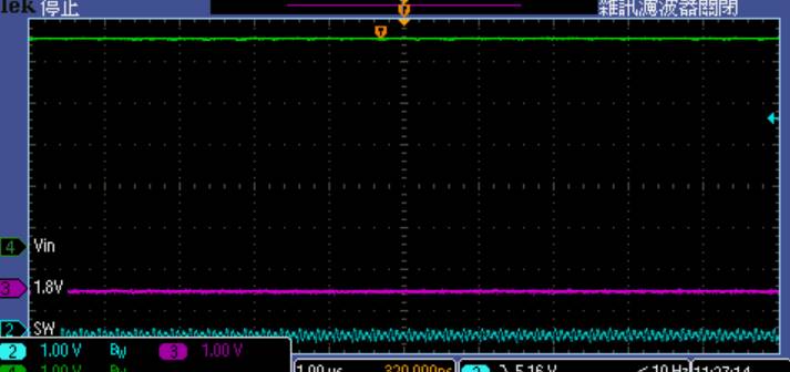

Finally the switching pin will settle at 0V as shown in below waveform

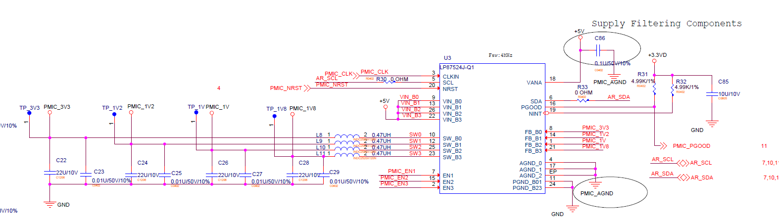

Below are customer's schematics,
    Based on the scope plots provided, it is very difficult to provide any feedback on why regulators stopped switching.
    * Can you please ask them to probe, NRST and EN1 signal to make sure that these are not going down?
    * check the inductor current (or VIN current) to see whether it is hitting the current limit due to some short circuit on the board.
    * In this schematic, i dont see the input capacitors and have they placed those capacitors according to datasheet guidelines?
    Below are couple of points I noticed on the schematics, but in general, these should not cause the PMIC shutdown behavior
    * On the output side, we recommend atleast 2x22uF output capacitors on each regulator for improved stability.
    * For 5V input, we need snubbers on the switch pin.
