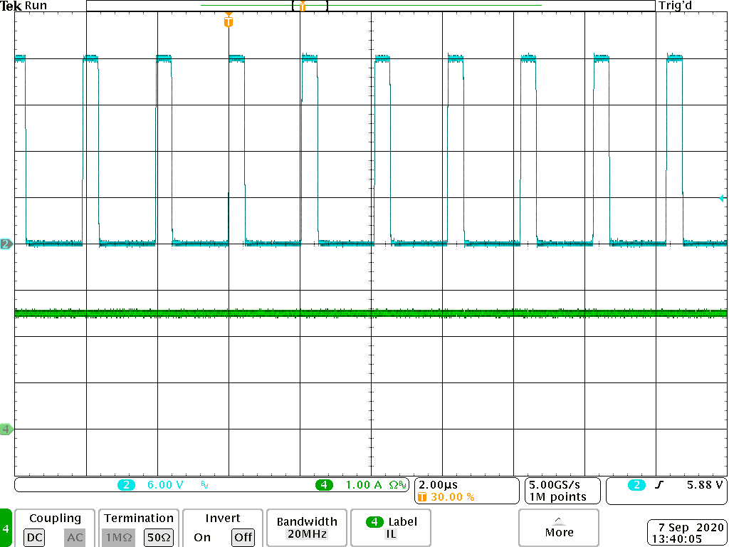

Hi TI team,
I pull MODE pin (#17) to 3.3V and power on the device with Vin=24V, Vout=4V, Iout= 2.5A.
The switching frequency should be fixed in 580kHz, but the waveform doesn't appear that. I attached the switching waveform for troubleshoot.
Since I cannot find the waveform in datasheet at the same condition. Need your help to comment.
Btw, if I reduce Vin to 12V, Vout=4V, Iout =2.5A, the switching waveform shows fixed.
Thanks.
