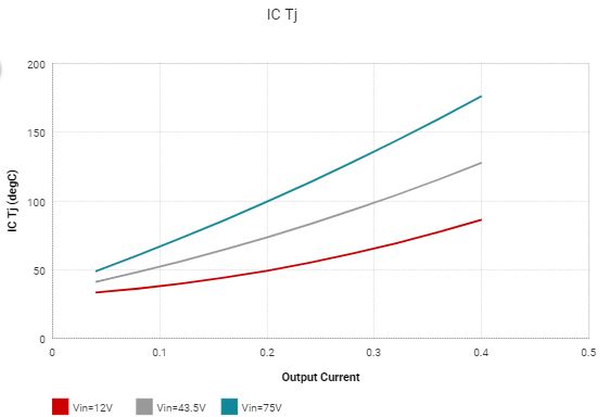

WEBENCH® Tools/LM5007: WEBENCH giving alert, even though I am keying AN-1298 components value
Part Number: LM5007
I am trying to simulate my DCDC design and WEBENCH giving alert "U1 Junction temperature is too high". Then, I am trying to use the same components value from AN-1298, unfortunately I am still getting the same alert from WEBENCH.
Just to confirm with you if there is issue on the WEBENCH for LM5007?
