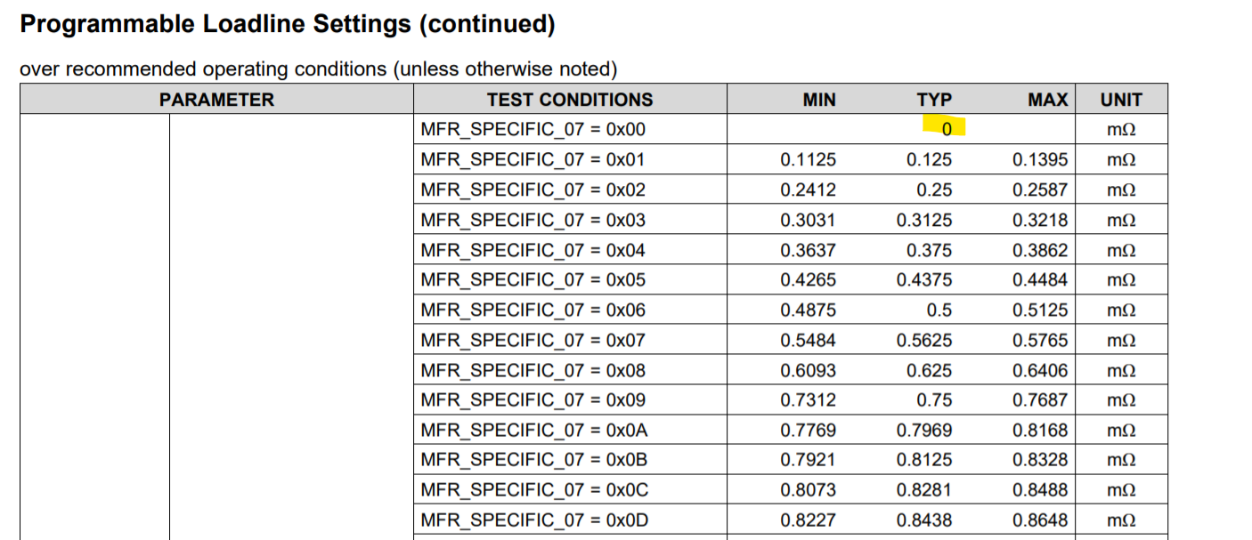

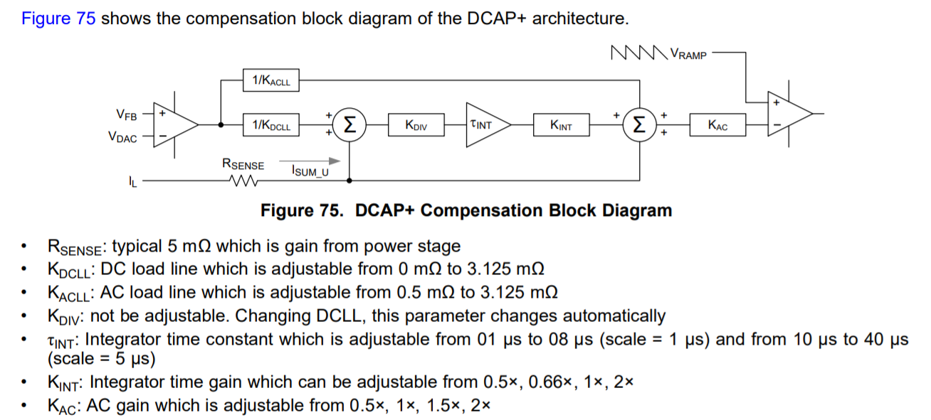

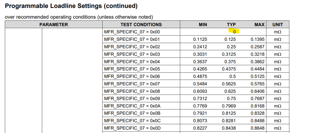

Hi expert,
in TPS53681 datasheet, we see ACLL range can start from 0mOhm (P13), however in Fig75,ACLL is suggested to begin from 0.5mOhm.
What would happen if ACLL is lower than 0.5mOhm?
From the control block diagram, 1/ACLL is just used as feedforward, it seems it won't affect stability of the system.
