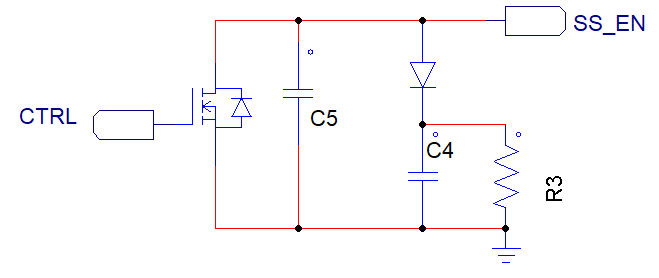

  • Hi Aneesh
    A1/ The Cycle-by-Cycle current limit will protect the MOSFETs from an output short circuit PROVIDED that the MOSFETs are rated to carry the currents that flow between the time when the short is applied and the switching stops - the ILIM time shown in Fig 42 in the Data Sheet. You can shorten the time spent in ILIM by reducing the value of the SS capacitor.
    You also have a possibility to turn the PSU off completely by pulling the SS/EN pin to GND but of course to do this you will need some method to detect the short circuit and a small signal MOSFET to pull the SS/EN pin to ground.
    A2/ If you want a latching shutdown of the converter then you can put a potential divider at the SS/EN pin, use 100k from SS/EN pin to VREF and 180k from SS/EN pin to GND.
    If you need a faster response then you will need some method to detect the over current condition and then use that to turn on a small signal MOSFET from SS/EN to GND. You could set up a comparator to look at the SS/EN voltage and detect when it drops below the 'Normal operating' level (min is 4.2V).
    You will get a faster response if you can use a smaller capacitor at the SS pin - at the expense of a shorter soft start time.
    You could experiment with an arrangement like the one shown below where the SS starting ramp is controlled by the sum of C5 and C4 but the discharge is governed by C5 alone. R3 discharges C4 during the non-switching - hiccup - interval. The MOSFET can be use to enable the controller and to disable it when you detect an over current event. NOTE: using two capacitors in this way is an idea only, I have not implemented or tested it on hardware although I'd have a high degree of confidence that it will work.
    Colin
