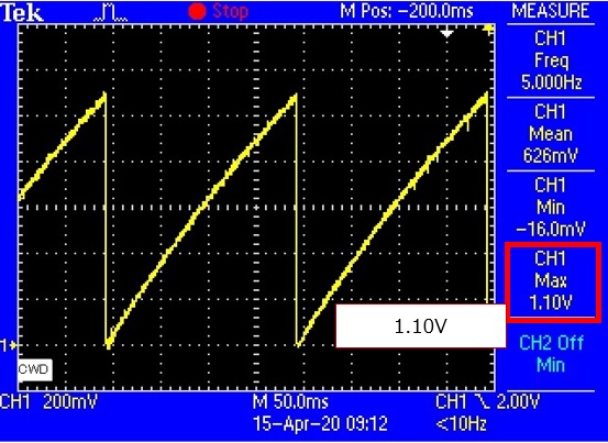

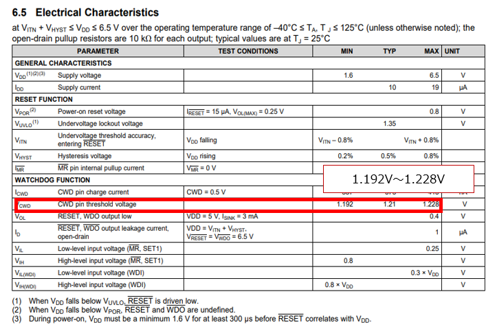

When the "CMD" terminal was measured, it was found that there was a discrepancy with the value stated in the data sheet.
Two capacitors (0.047uF, 0.01uF) are connected in parallel to the CMD pin.
<Measured value>
<Theoretical value>
◆Question
The measured voltage is 1.10V, which is different from the theoretical value in the data sheet.
・Do you know the reason for this?
・Also, is there a problem if the theoretical and measured values do not match?
  • Hi user,
    Are you getting a consistent 1.1V regardless of the capacitor used?
    Abhinav.

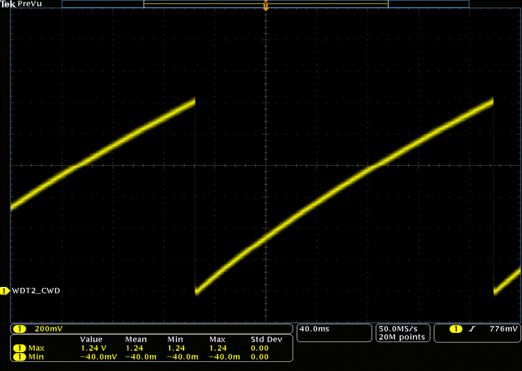

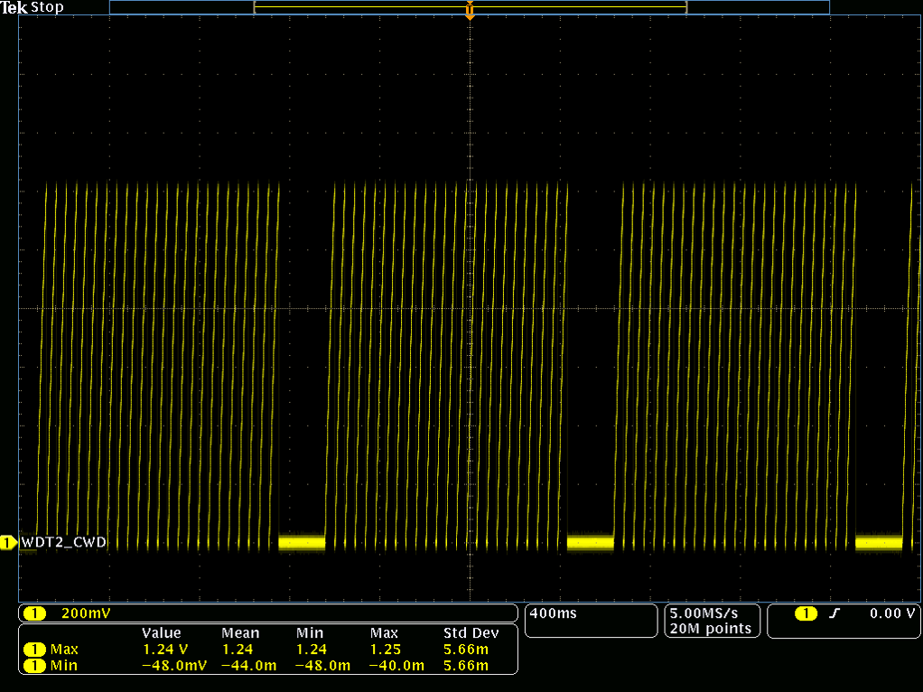

    <Re-Measured value>
    1.24V.
    Even if the capacitor is changed, the theoretical value and the measured value match.
    <Measured value>
    One capacitors (0.01uF) is connected to the CMD pin.
    1.24V.
