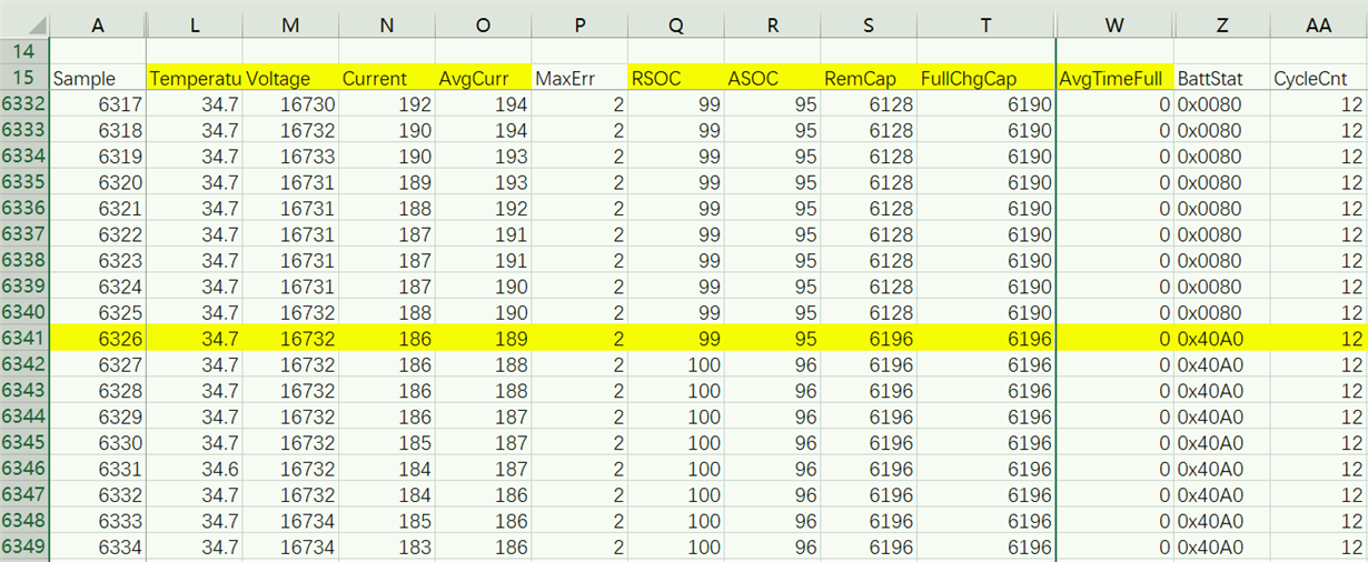

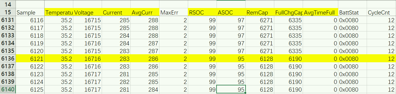

When i run a charging test , i found that the Fullchargecapacity(FCC) was updated before the valid charge termination.
When completed the charge, i check the FCC value,i found that the FCC value was updated when the charge current is 286mA before the valid charge termination.
After a while ,the FCC value was updated again when the valid charge termination(charge current is 186mA, the accuracy is ±20mA). I think , this FCC update is normal.
I want to know whether FCC value update is normal under such a current 286mA (when the taper current has not been reached)? What caused the FCC update?
