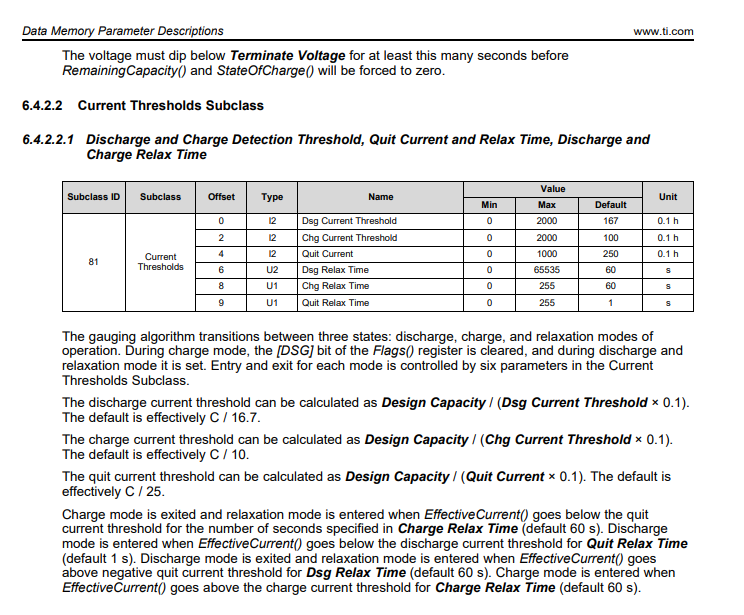

In my device a I have permanently attached battery (nominal 1100mAh, 3.7V) which is charging with maximum 1A current and charging is terminate when current drops below 50mA. Device draws 20mA - 50mA in normal condition and below 100uA when is in standby. It is also in standby when voltage at battery drops below 3100mV.
After power up device checks if ITPOR is 1 and initialize   BQ27421-G1A with this values:
Design Capacity = 1100
Design Energy = 4070
Terminate Voltage = 3200
Taper Rate = 192
Sleep Current = 5
Hibernate I = 1
Hibernate V = 2750
Dsg Current Threshold = 733
Chg Current Threshold = 244
Quit Current = 1100
 OpConfig[HighByte] = 0x05
then execute command:   BAT_INSERT, SET_HIBERNATE, SOFT_RESET.
After few charge/discharge periods i realized that  FullChargeCapacity( ) is around 1227mAh and SOC seems to be properly estimated. But SOH Status is always 0x00 (SOH Value is same as SOC).
Is my settings ok?

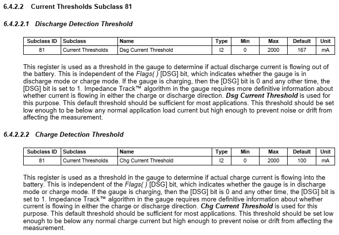

In SLUUAC5 (June 2013): Dsg Current Threshold, Chg Current Threshold, Quit Current have units [mAh] but in bqStudio (Version : 1.3.86) they are in [0.1 Hr rate]...
