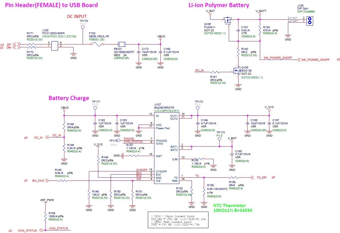

My customer using BQ24078 test Inrush current but fail for spec., would you pls advise the way to solve it?

Still fail after pull EN2 low, test report at attach.
Do you have others ideal?
