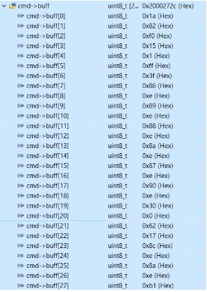

  • HI Matt,
    Sorry for the late response.I missed your response last week and hence could not give the more details.
    Following is the sequence I use for reading the data from manufaturing access() upon writing 0xF082.
    1. Manufacturing status read to check CAL_EN through manufacturing access():
        Read command --> 0x16 0x23 0x17 0x02 0x00 0x80
    2. Write 0xF082 through manufacturing block access():
       Write Command --> 0x16 0x44 0x02 0x82 0xF0
    3. Read data from 0xF082:
       Read command --> 0x16 0x44 0x17 0x1A 0x82 0xF0 0x15 0x01 0xFF 0x3F 0x86 0x0E 0x89  0x0E  0x88 0x0E 0x8A 0x0E 0x87 0x0E 0x90 0x0E 0x30 0x00 0x62 0x17 0x8C 0x0E 0x8A 0x0E

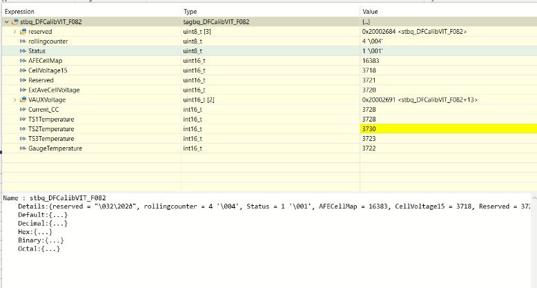

  • Hi Matt,
    I see that even after making CAL_EN I cannot fetch the latest value after every 250msec from the bq78350. I see that the value do not get refresh as the rolling counter on reading 0xF081 and 0xF082 has always same counter value.
    Can you give me the steps I need to perform to get the rolling counter moving 0xF081 and 0xF082?

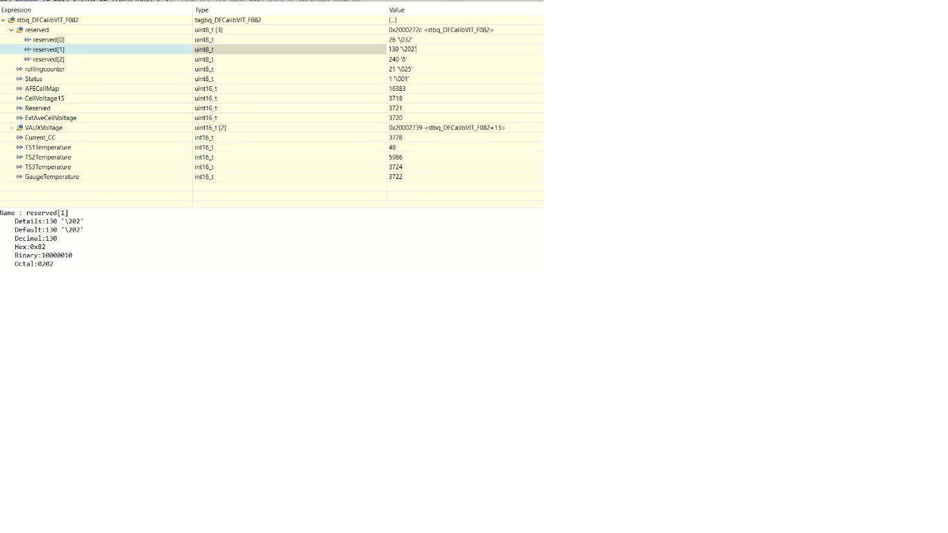

  • Hi Matt,
    I am reading in a gap of 50msec for 5 times and checking the status bit on read of 0xF081 / 0xF082 to check its validity.
    In between the 50msec on executing this same sequence  I see the rolling counter value is same.
    Hence, I fell some how I am missing the command where I can again restart the ADC calibration value and get the latest value on read of either 0xF081 / 0xF082

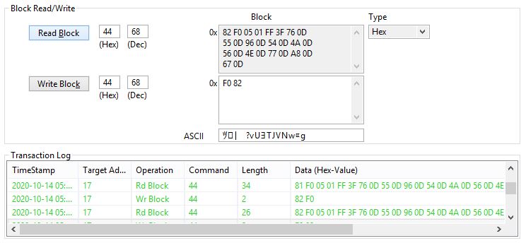

  • Hi Matt,
    On bqstudio also I am getting the data of 0xF081 on 0xF082.
    Please refer the attached screenshot.

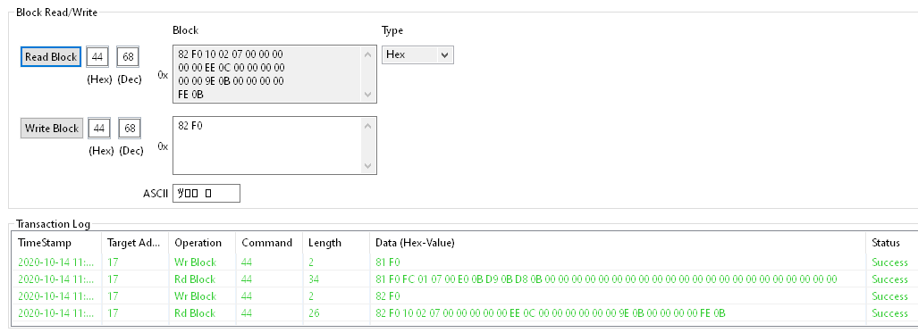

  • Hi Matt,
    In BQstudio also I am getting the same result, where on CAL_En the ADC raw data is not getting refresh. I get the value of 0xF081 on 0xF082.
    Please find the attached screenshot for reference .
  • Hi Shreyas,
    I repeated the same thing and cannot reproduce what you are seeing. I recommend reprogramming the R2 firmware to make sure nothing has been changed.
