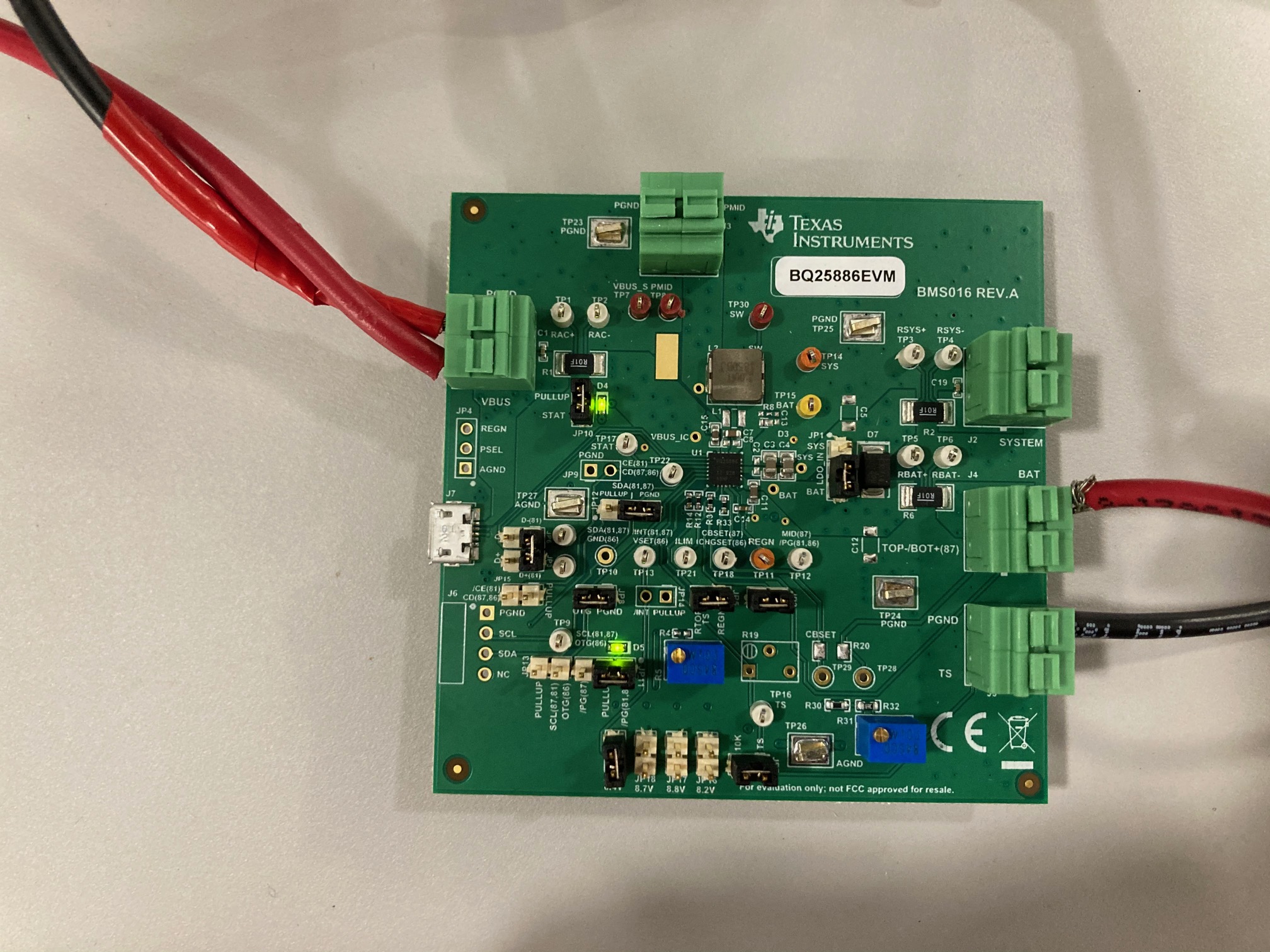

    From my observations I am seeing the behavior described in the datasheet. That is to say I am seeing a 20% of the ICHG value in JEITA cool. This is not aligned with the behavior you are seeing.
    I tested this on the BQ25886EVM and took detailed notes on my configuration. That I have shared below. Please review this configuration carefully and feel free to ask me elaborate further if I missed anything.
    Measured on BQ25886EVM:
    VBAT: 7.6 V
    VSET setting: 8.4 V
    V_ICHGSET: 427 mV
    D+ = D- = 0 V shorted to each other for maximum input current
    ILIM = 0 V shorted to GND for maximum input current
    R_TH measured from leads: 22.15kohm*
    *This is the resistor value I used to induce the JEITA cool condition in place of the thermistor. To induce JEITA normal condition a 10k resistor soldered to the EVM was used.
    ICHG_25C: 1039 mA
    ICHG_5C: 210 mA

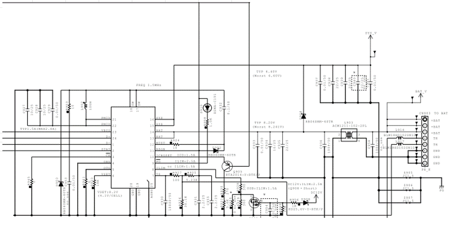

  • Hi Ricardo
    Thank you for trying,
    Our hope is recreate ICHGSET ×40% (normally 20 %) on COLD temp condition by the same customer condition, and become clear the reason of 40%.
    I modified customer condition, please see below,
    ・ILIM and ICHGSET: 1.5A, VSET_setting: 8.2V, D+ and D-: Short
    ・Customer schematic is attached (sorry for only rough picture), please see below;
       I pickup different point by EVM default without battery side and switching FET.
     ⇒L2: 10μH, C2: 0.01μF, C6: 10μF, C10: 0.01μF, C12: 22μF, C13: 10nF, add D3, R8: 10Ω, VSET: 8.2V (JP16),
      RICHGSET and RILIM is adjust by switching FET(base is1.5A)
      (Designator is based on EVM)
    ・The reason for add switching FET is able to flexible change ICHGSET and ILIM value.
    Satoshi
  • Satoshi-san,
    Unfortunately I was not able to recreate this issue.
    All findings are with VBUS: 5.5V; VBAT: 7.6V; ICHGSET set to 1.54A; VSET set to 8.2V
    Case one: ILIM is set to 1.5A MOSFET is OFF
    ICHG: 974.20 mA; REGN:5.0544V; TS: 2.5V, JEITA: Normal -> ICHG:297.78 mA; REGN:5.0493V; TS: 3.5V; JEITA: COOL
    Result: 297.78mA/1.54A = 19.33%
    Case two: ILIM is set to 2.85A, MOSFET is ON
    ICHG: 1.53896 A; REGN: 5.0594V; TS: 2.5V, JEITA: Normal -> ICHG: 298.10 mA; REGN: 5.0493V; TS: 3.5V; JEITA: COOL
    Result: 298.10mA/1.54A = 19.36%
    Ricardo
