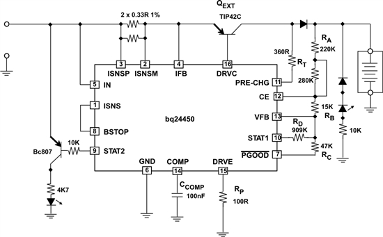

Hi There,
I have designed a charger using BQ24450 but i also want to know the charge status via a LED. I have connected a LED on pin 9 (stat2).
The problem is the LED sometimes works perfectly and sometimes not at all. It is ok if i can only show the status when it's boost charging but nice if i could also show float mode as well.
Why does the LED work only sometimes?
How can i show boost mode and Float mode?
