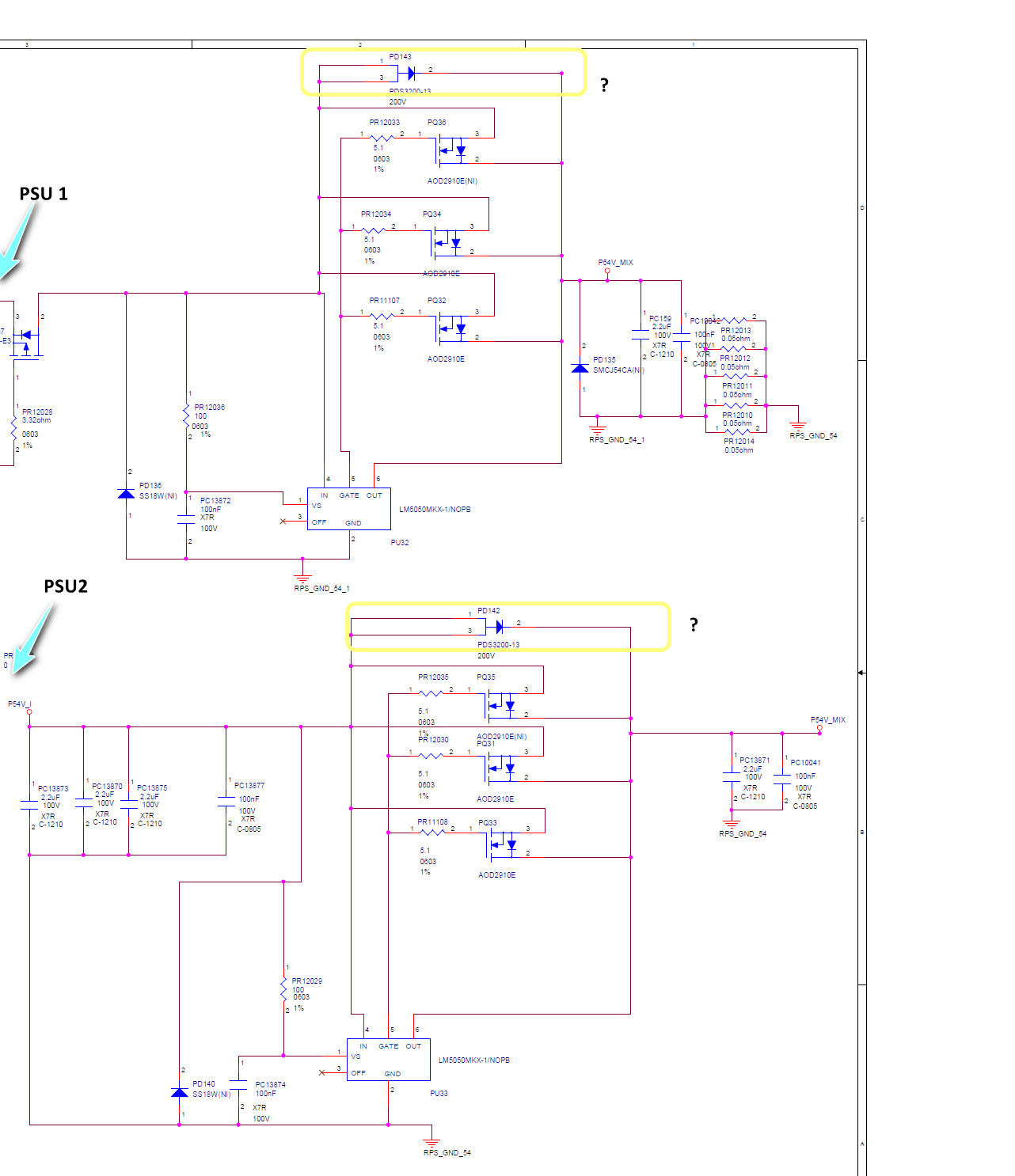

I am implementing the Or-ing controller for the redundant power supply application.
In some circuitry, I see the Schotty diode between the input and out.
I have no idea what's the purpose of this design since the main idea of implementing the LM5050 is to replace the diode.
Can you share the idea of it?
  • Hi Joe,
    Welcome to E2E!
    Schottky diodes are used in parallel in high current systems to reduce the stress on the body diode of the MOSFETs before they get fully turned-ON by the LM5050 controller.
    Best regards, Rakesh
