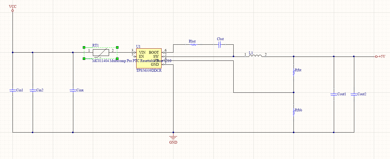

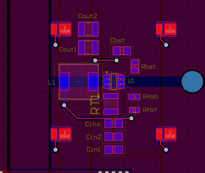

I am using the TPS56339DDCR buck converter in a custom circuit. For the circuit design I have used a reference design from WeBench Power Designer. An image of the circuit design is attached.
I have tried to follow the recommended circuit layout as closely as possible.

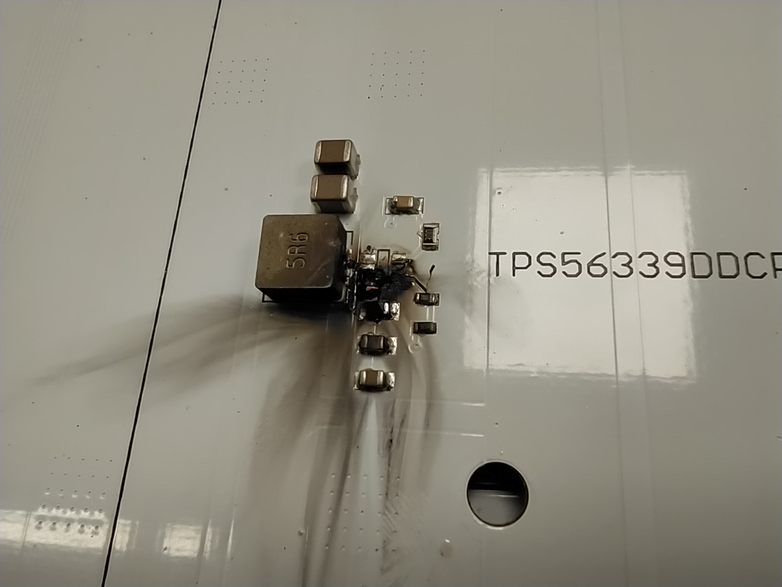

In the occasion of short circuit failure, several of the buck converters have been destroyed and one even had a small electrical fire. The reason so many shrts occured is because we are trialling a modular board-to-board connection system which still has a few kinks to iron out.
I have attached a picture of the aftermath of one of these failures.
So far the only solution I've been able to come up with is to add a resettable fuse to the input of the device, but if you could indicate any methods to provide additional safety measures it would be appreciated.

    Could you share the schmatic and layout to us ? and what's the failure rate by short test ?
    BRs,
    Young

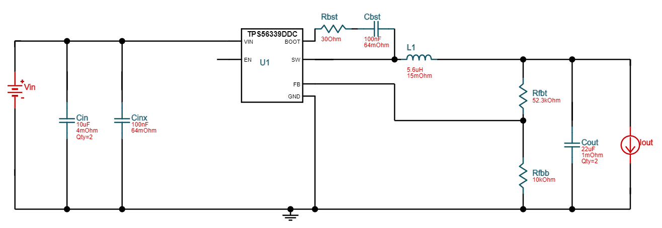

    Schematic and layout are below.
    Values for schematic:
    • Cin1 = 10uF
    • Cin2 = 10uF
    • Cinx = 100nF
    • Rbst = 30 ohm
    • Cbst = 100nF
    • L1 = 5.6uH
    • Rfbt = 52.3 kohm
    • Rfbb = 10 kohm
    • Cout = 22uF
  • Not sure the images were uploaded properly there, so I've reattached them.
    I think I have figured it out.
    After trying to recreate the short circuit fault, I realised that shorting VIN to GND would not destroy the chip.
    Then I noticed that there are some magnets that are screwed onto the board that have rubbed off some of the soldermask which could potentially short my +24V input to the +5V output from the converter. I think this is what destroyed the device.

    Great to hear this issue was fixed . Please let us know if you have any other question . Thanks .
    And based on our previous short test on TPS56339, IC may damage only happened when SW short to VIN .
