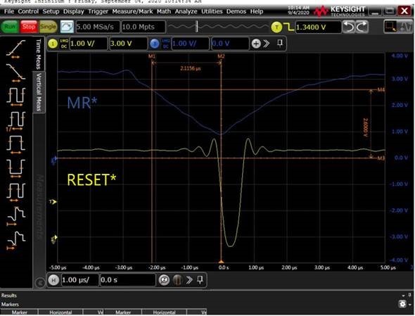

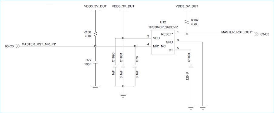

One of my customers is currently using TPS3840PL26DBVR and they reported a problem with the reset output signal.
They asserted MR input but the reset output was asserted only for about 1us.
Please check their schematic and signal captures and give advice.
- Customer schematic
-  Signal capture #1 (Reset output and VDD)

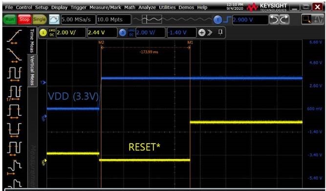

The following is signal captures of reset output and VDD.
There is no problem with reset output signal by VDD.
-  Signal capture #2 (Reset output and MR* input)
They asserted MR* input but reset output signal was asserted only about 1us, much shorter than the minimum reset time delay of 50 us.
Can you please check the problem and give advice why the reset signal is working properly?

  • Hi Kevin,
    Looking at the "Signal capture #2 (Reset output and MR* input)" waveform, the /MR voltage waveform is between 750mV to 1V.  The /MR logic low input spec is 600mV or lower.  Have the customer remove C76 and repeat the test.  Please let me know if there are any other questions.

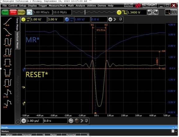

    I have attached another signal capture.
    It was MR* input and RESER output signal capture after removing two parallel capacitors (C76, C77) on MR* input line.
    As you can see, there seems to be no problem with MR* input signal.
    However, RESET output signal behavior is very strange.
    Please give your advice why RESET output is not working properly.
    Kevin.

  • Hi Kevin,
    The photo below shows the /RESET signal working correctly.  When /MR is asserted, /RESET is asserted after ~450nS.  Base on the /RESET waveforms, it appears that CT is floating.  The time (tMR_tD) is around 50uS.  Can you verify if there is a 220nF capacitor connected to the CT pin to GND?

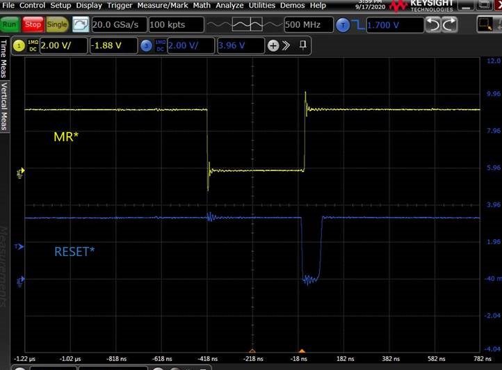

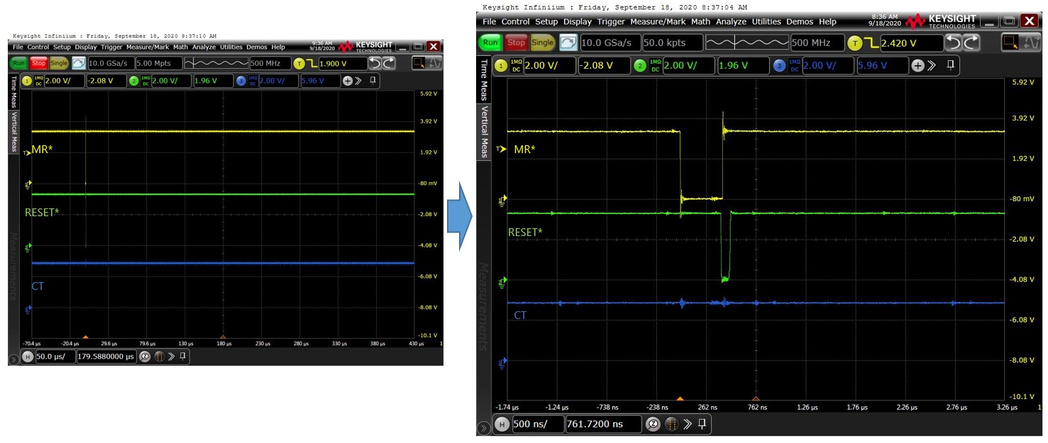

  • Hi Ben,
    I have attached /MR, /RESET and CT signal capture.
    Please check it and give your advice.
    As you can see at left side, if /MR falls to low for a very short time like glitch, /RESET is asserted although it is also very short time.
    My understanding is correct, /RESET should not fall to low in this case.
    Can you please let me know why /RESET output is asserted by very short-term /MR input?
    And the customer checked /RESET output after removing CT capacitor, i.e. 220nF.
    In this case, /RESET should remain low level for about 50us. Right?
    However, the result was the same as the capture on the right.
    Kevin.
  • One more question.
    The customer is using TPS3840PL26DBVR.
    It is a Push-Pull variant and the datasheet describes that it does not require a pull-up resistor.
    But the customer applied a pull-up resister on /RESET output.
    Can this pull-up resister cause a problem?
    Kevin.
  • Hi Kevin,
    I think I see the problem.  The /MR pulse is so short that the voltage on the CT pin does not react at all.  Can you remove the CT capacitor and repeat the test?  The voltage on the CT pin should go down without the capacitor.
    Adding a pull-up resistor on the /RESET pin should not cause this issue but just for experiment, can you also remove the pull-up resistor?
    Ben

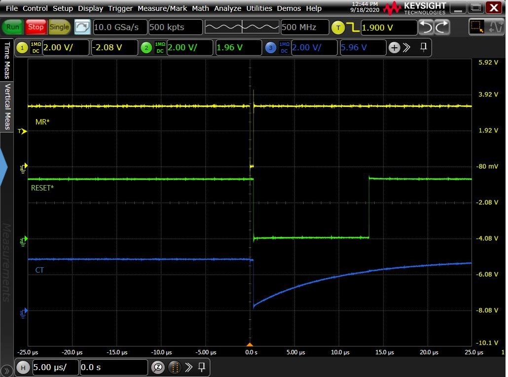

  • Hi Ben,
    Please refer to the below picture.
    It was signal captures after removing the capacitor connected to CT pin. (CT pin was floating)
    As you can see, the voltage of CT pin goes down and then slowly returns to high level.
    And /RESET delay time increases a lot compared to before but it is still shorter than 50us.
    Can you please check the signal captures and give advice?
    FYI, removing the pull-up resistor connected to /RESET output pin does not affect the result.
    Kevin.
  • Hi Kevin,
    Thank you very much for the scope capture.  This explains a lot what is going on.  The /RESET delay, on the scope capture, is shorter than 50uS, which meets the datasheet spec.  Basically, the reset time delay should not be more than 50uS when the CT pin is left open.  Therefore, the part is functioning correctly when CT pin is open.
    Having a 220nF capacitor on the CT pin and the scope capture showing (see below) the voltage on the CT pin not discharging to GND means the assert time of /MR is not long enough.  From the scope capture, the assert time of /MR is too short resulting in the voltage on CT to stay at its original value.  Therefore, the assert time on /MR needs to be longer to have the CT pin voltage discharge to GND.
    Just for your reference, the paragraph on top of page 18 explains the situation you are experiencing with your circuit.
    Please let me know if you have questions.
    Ben

  • Hi Kevin,
    There is no table referencing the /MR assert time to the capacitor value connected to the CT pin.
    From the schematic, it is showing that a 220nF capacitor is connected from the CT pin to GND.  Base on equation 4 from pg 17 in the datasheet, the delay time is calculated to be around 136.22ms.  Try a /MR assert time of greater or equal to 1% of the delay time (1.36ms or longer).
    To your second question, the scope photos that you have provided shows a /MR reset time of greater than 300nS.
    Ben

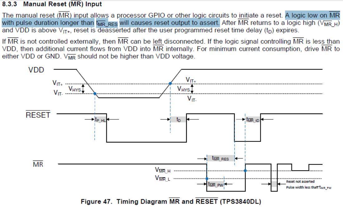

  • Hi Ben,
    The customer have confirmed that /RESET is working properly if they assert /MR more than 1ms.
    By the way there seems to be some confusion in the datasheet description for /RESET output by /MR input.
    The following is a description of /MR input in the datasheet.
    There are two descriptions for /RESET output by /MR input.
    1. A logic low on /MR with pulse duration longer than tMR_RES (typical 700ns) will causes reset output to assert
    2. Reset not asserted Pulse width less than tMR_PW (typical 300ns)
    The latter tell me that /RESET will be asserted if /MR is asserted more than 300ns.
    You also confirmed this.
    But the former tell me that /RESET should not be asserted if /MR is low less than 700ns.
    I'm confused.
    Can you please explain the exact behavior of /RESET output depending on /MR input?
    FYI the customer has been using a RESET IC in many products and also has a plan to replace the existing RESET IC by TPS3840.
    So please help me to give exact information.
    Kevin.
  • Hi Kevin,
    The statement:
    "1. A logic low on /MR with pulse duration longer than tMR_RES (typical 700ns) will causes reset output to assert"
    is not correct.  Thank you for pointing that out to me.  Everything else that we have discussed is correct.
    The timing diagram is correct as well.  Please disregard the statement.
