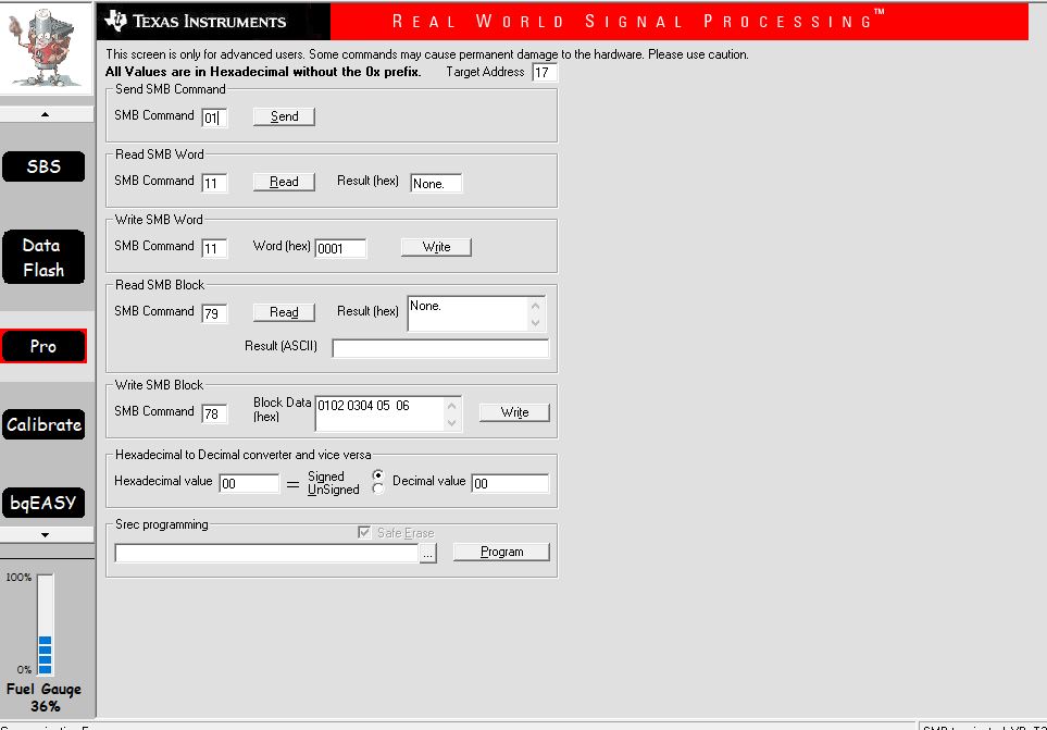

Hello Suresh,
Yes, use the advanced pro tab to send the commands. Also make sure the gauge is in full access mode and after sending the command don't communicate with the gauge for 1 minute otherwise it will not enter sleep mode.

Hi Wyatt,
The Gauge is in full access mode
Can you send send the sequences in advanced pro. I'm not sure which sequences I have to use Read SMB Word, Write SMB Word, and Send SMB Command to force the device in sleep mode.

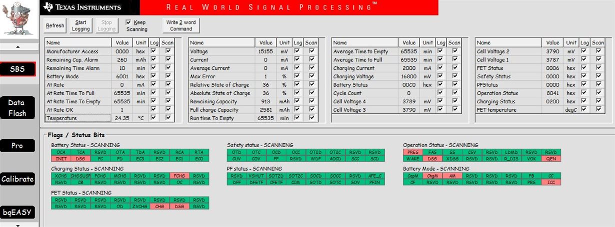

Hello Suresh,
I would follow the steps Kang outlined. Can you send a screenshot of your communication tab interface? We currently don't have quick access to test on boards.

Hello Suresh,
Can you also send a screenshot of the pro tab which you are trying to use to communicate?

Hello Suresh,
You should send a block write command with SMB command 0x00 and block as 11 00 to put the gauge in sleep mode.
