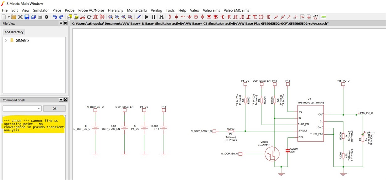

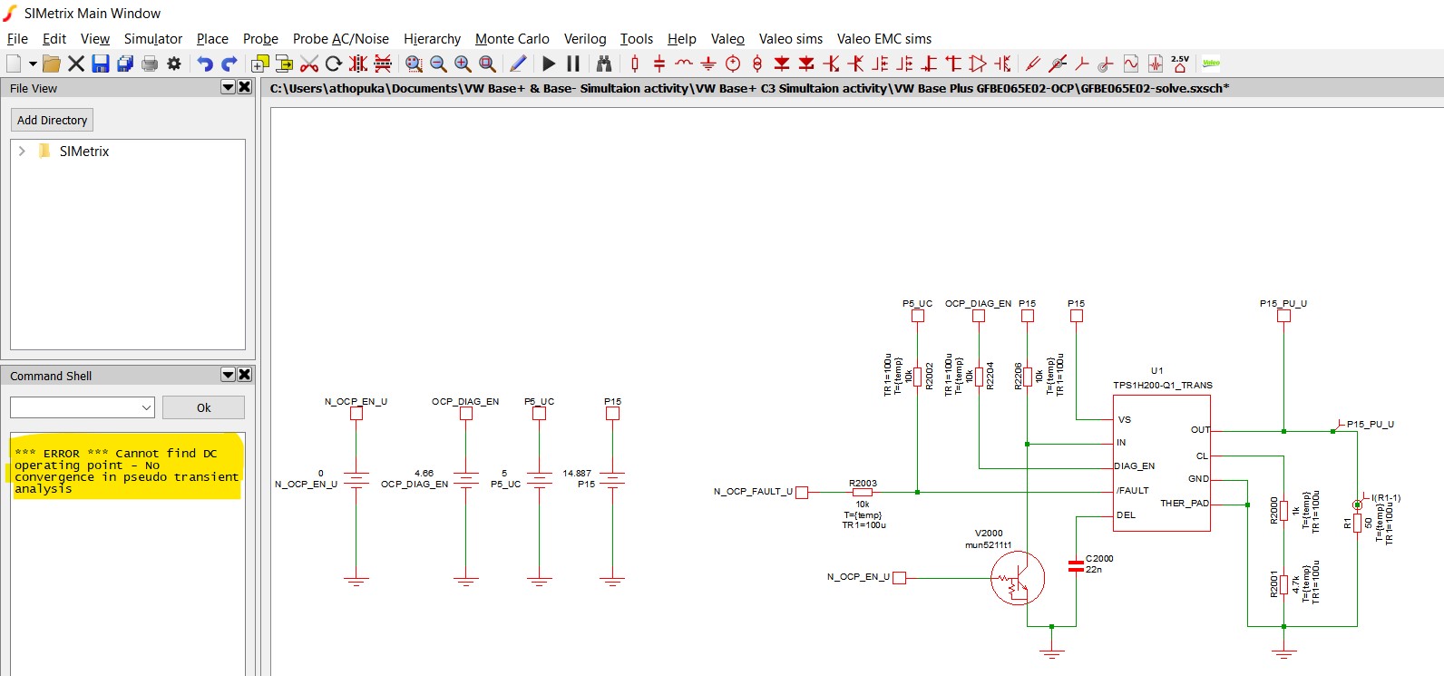

TPS1H200A-Q1: Spice code Error while simulating in Simetrix at Tamb = -40 & +105 °C
Part Number: TPS1H200A-Q1
While simulating the IC TPS1H200A-Q1 in Simetrix with an ambient temperature = -40 & +105 °C, I am getting an Error "Cannot find DC operating point - No Convergence in Psuedo Transient Analysis".
When I see the simulation failure status report, its shows that Ideality Factor (n or N) for a component (Diode mentioned in spice code - .MODEL dd d ( is=1e-015 n=0.01 tt=1e-011 )) which is a subckt of TPS1H200A is around n = 0.01. As the value of n value is usually 1-2.
I considered n as 1 for simulation (.MODEL dd d ( is=1e-015 n=1 tt=1e-011 )) which would resolve the issue. Can you please confirm the way which I am simulating is correct or not.
If not, please provide me an alternate simulation for resolving this issue.
Thanks & Regards
Athieshkumar T
https://e2e.ti.com/cfs-file/__key/communityserver-discussions-components-files/196/TPS1H200A.7z

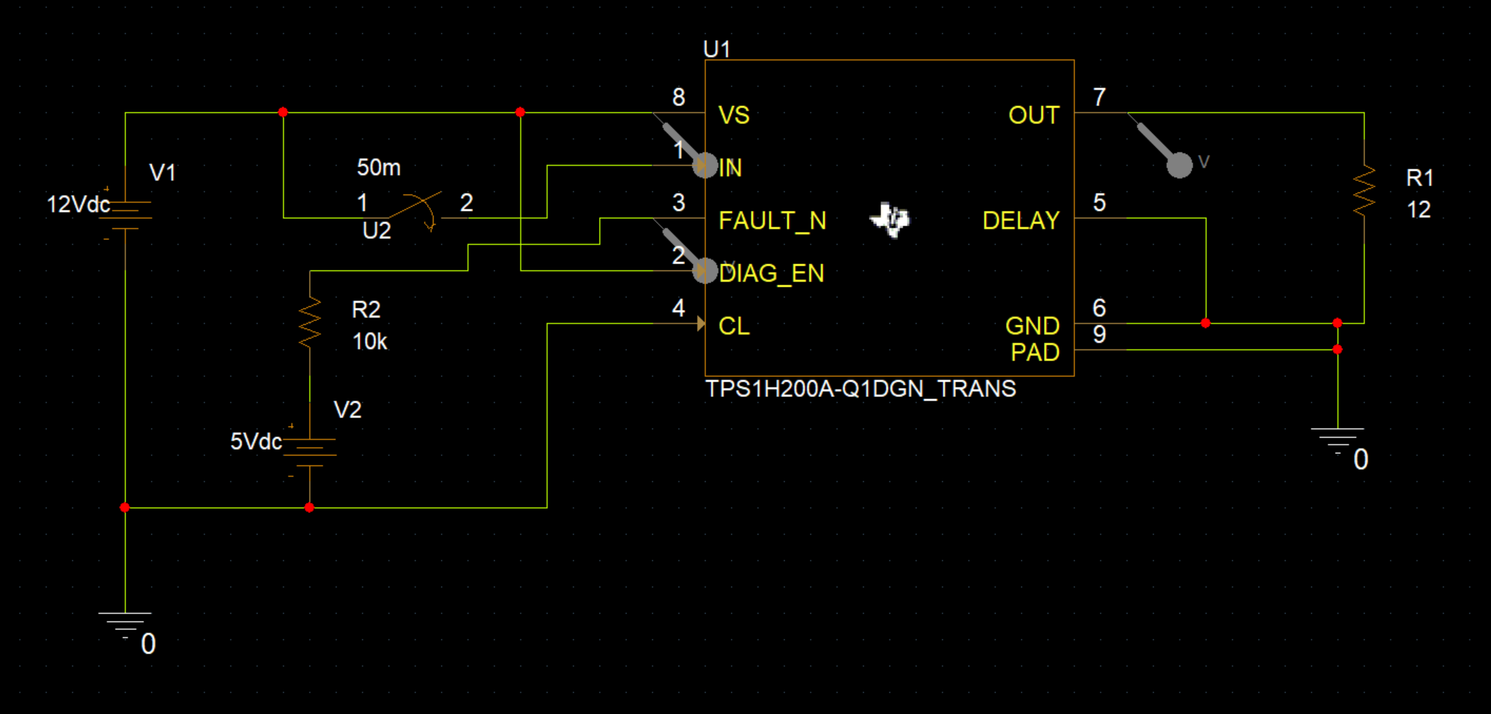

  • Hi Timothy Logan,
        Thanks for your reply. I am using TPS1H200A for current limiting purpose. Did you simulate the same in Pspice for different temperatures with the existing spice model of TPS1H200A? If yes, did you get any any convergence problem? I just simulating the existing spice model with passive elements connected as shown in above thread for checking temperature variations.
    Is there any way to modify spice model for resolving convergence issue?

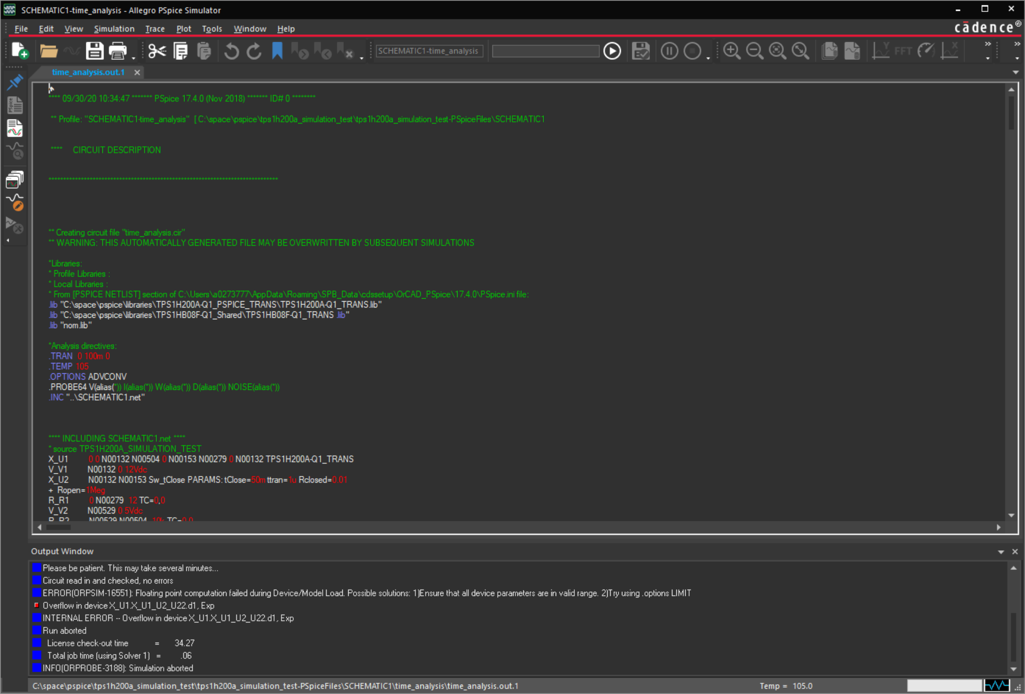

  • Hello Athieshkumar,
    I have simulated using Orcad Cadence CIS 17.4 PSpice at different ambient temperatures without any convergence problems. The model will not be able to currently be able to tell you how hot the device will heat up as thermal modeling has not been added to the model's capabilities (it is planned to later this year).
  • Hi Timothy Logan,

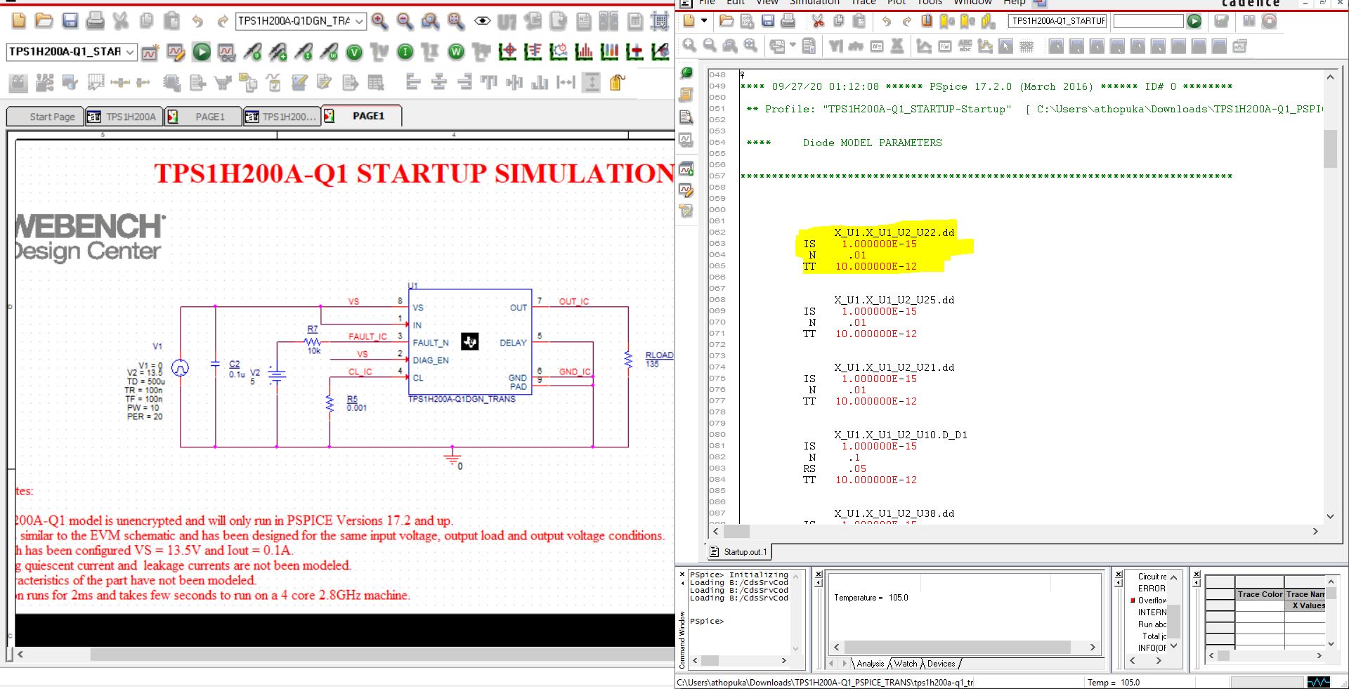

        I have simulated the TPS1H200A (Rev C) transient model in Cadence PSpice 17.2 downloaded from TI website. As my requirement is that to simulate the effect of passive components at different ambient temperatures. I don't require the thermal variation of IC as of now. So I simulated the entire model with different ambient temperatures (-40deg, +25deg & +105deg). I am attaching the .out file for your reference. Please look into this and suggest me a solution.

     ****     Diode MODEL PARAMETERS
                   X_U1.X_U1_U2_U22.dd
              IS    1.000000E-15
               N     .01
              TT   10.000000E-12

    ERROR(ORPSIM-16551): Floating point computation failed during Device/Model Load. Possible solutions: 1)Ensure that all device parameters are in valid range. 2)Try using .options LIMIT
    INTERNAL ERROR -- Overflow in device X_U1.X_U1_U2_U22.d1, Exp
    ABORTING SIMULATION

    I am working on reproducing this now and will get back to you by the end of the week.
  • Athieshkumar,
    I was able to reproduce this issue locally using Cadence 17.4:
    I will report this bug to the modeling team and work to get it fixed. This generally takes about two to three weeks turnaround. When it is fixed I will follow up with you offline.
