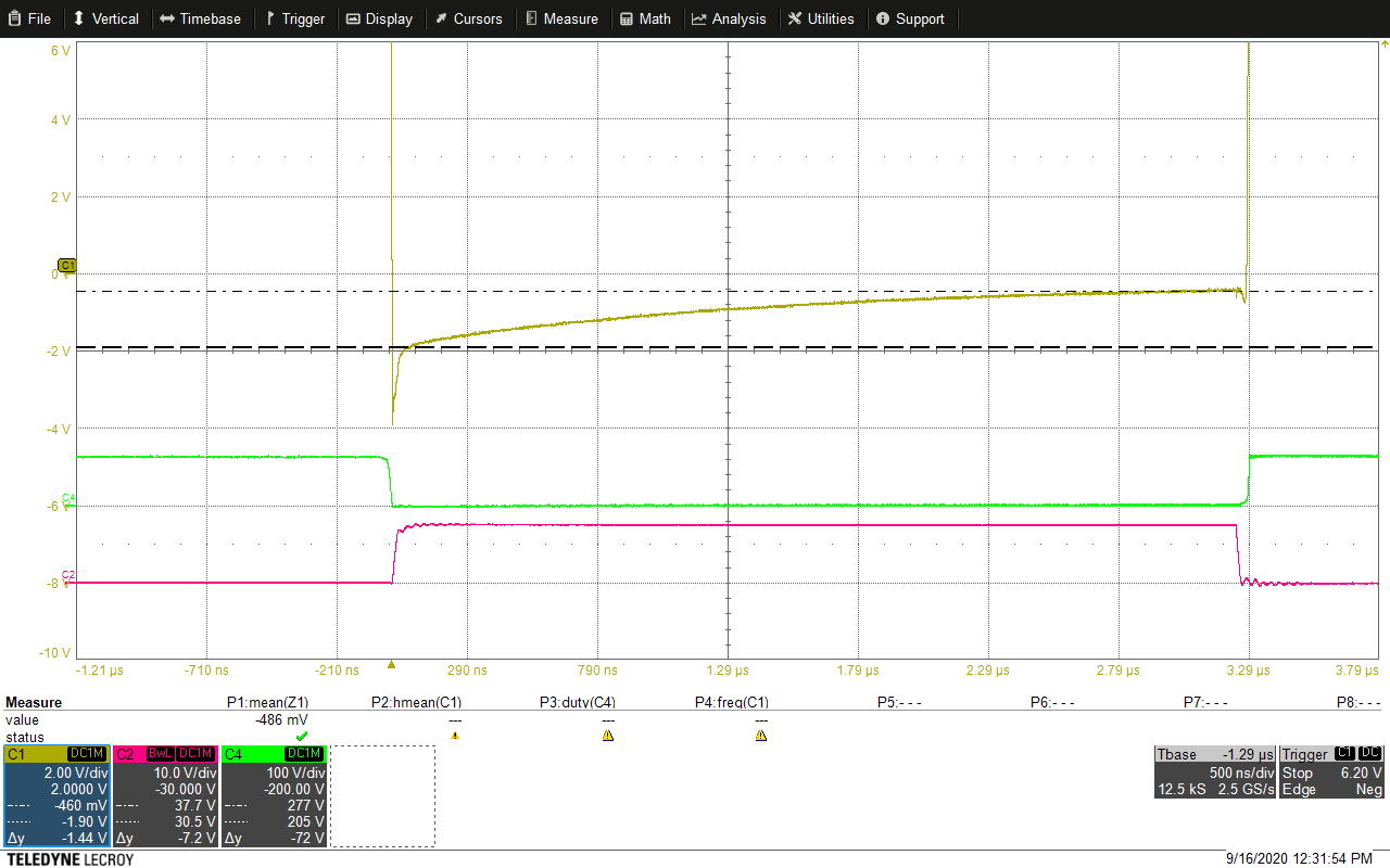

    I have checked the Vgs voltage and I also have increased it up to 12V. Please check the plot below. From my point of view, the low side FET should be 100% on. I can't understand why the voltage drop is so high when the current is around 8A.
    The point is not only the power dissipation. It is also that the SW pin of the LM5145 should not be below -1V longer than 20ns. So it looks like that the signal below could damage the IC.

  • Hello Silvano,
    I understand your concern now.
    I believe it is not too much reason for concern. Inductor ramp up will result in a dynamic VDS.
    The calculation you are doing maybe too simplistic, though I am unsure.
    Are you having difficulties with the loss of the converter or its regulation?
  • HI Silvano,
    The transient negative spike related to energy in the switching loop parasitic inductance. See app note slyt682. This parasitic inductance is minimized by correct and close placement of the input caps near the FETs - see app note snva803 for more detail.
    The SW node copper area seems very large in your file. This should be minimum area to mitigate EMI (see the LM5145 and LM5146-Q1 EVM PCB layouts as examples of recommended layouts. Also, see the LM5145 datasheet for PCB layout guidance.
