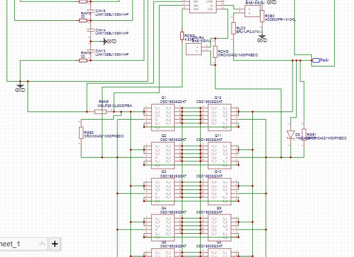

Hi Sir,
I have paralleled the MOSFEts without any individual gate resistor as shown in the image below. Will circuit still work? If yes How will this effect performance of my BMS?
Using multiple FETs is a common configuration. I would highly recommend reading this app note for more information. The BQ77905 is extremely similar to the BQ77915.
