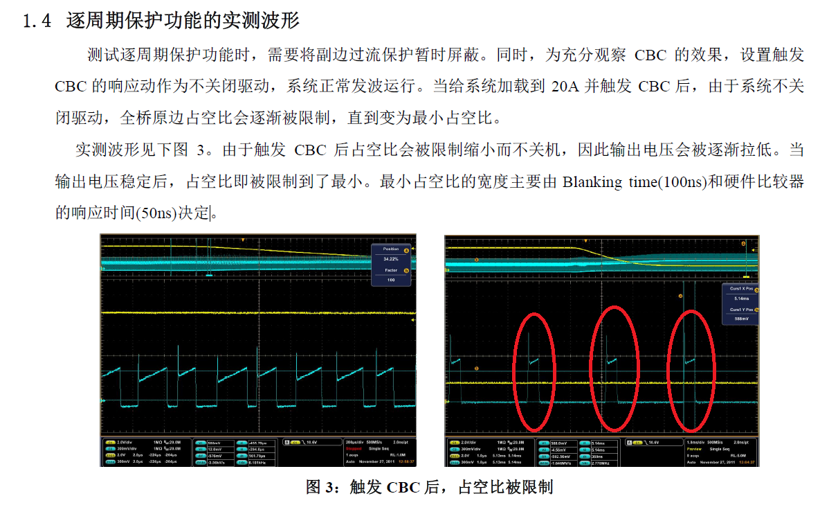

what's the meaning of blanking window duty output if the current continuous over cbc level, why does it not keep zero duty until the current within the cbc level ,thanks.

Pls see the attachment and give me some suggestions ,thanks.UCD3138的逐週期保護功能說明.pdf
the CBC function is disabled during blanking window, so even if the current signal exceeds the CBC threshold during blanking window, the PWM pulse width is not chopped. To reduce this minimum duty, you can reduce the blanking window.
Hello, the blanking window is used to prevent CBC from being mis-triggered by any spike at the beginning of the current sense signal. You can change the blanking window as far as you can guarantee that CBC will not be mis-triggered.
