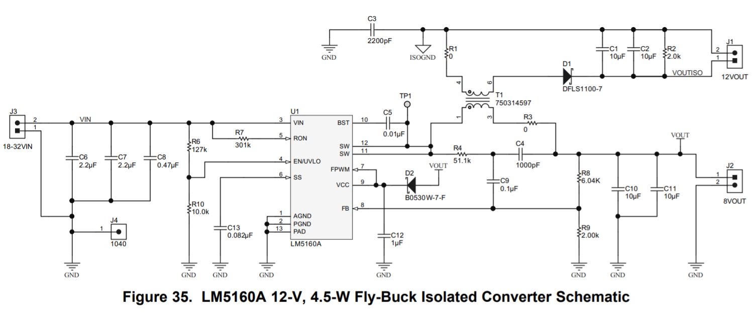

Hi
Is it possible to cut the parts-count down by half, from 24 parts down to 12 parts, in your reference circuit, in the datasheet?
https://www.ti.com/lit/ds/symlink/lm5160.pdf
- thx

HI
I can't see the attached picture, which figure you means? and what part you need support , LM5160 or LM5161?
and what's your application ,buck or flybuck?

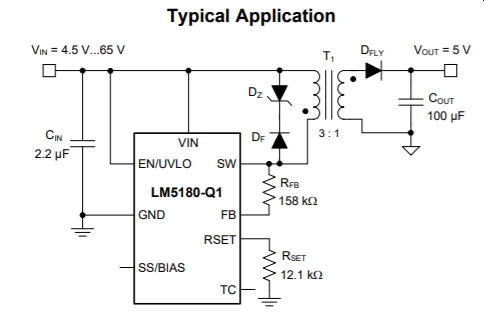

HI
you can take look at LM5180 as PSR flyback, it can reduce the total component number.
for LM5160,you can only combine some input and output capacitor
Daniel Li14 said:you can take look at LM5180 as PSR flyback, it can reduce the total component number.
Do you mean fewer parts than shown in the datasheet?
