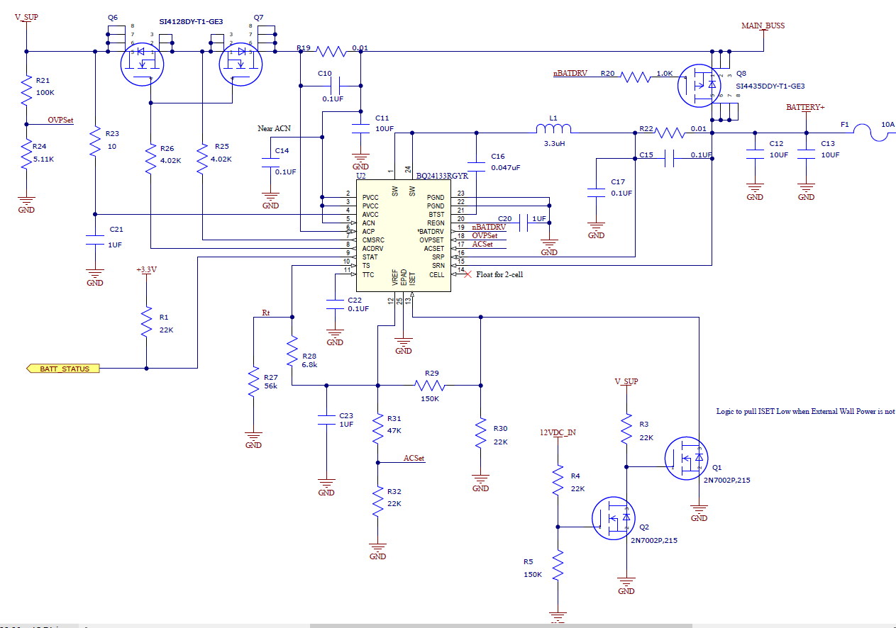

BQ24133: ACDRV not driving FET's
Part Number: BQ24133
In my schematic, I am unable to get voltage to pass from the input N-Ch MOSFET's (Q6 and Q7) to the Main_Buss System output voltage in my schematic.  It appears that ACDRV is low and is not turning on the MOSFET's.  What are some conditions that may prevent this from going high per the charge pump voltage?  I have 12V on AVCC and my VREF is 3.3V.
