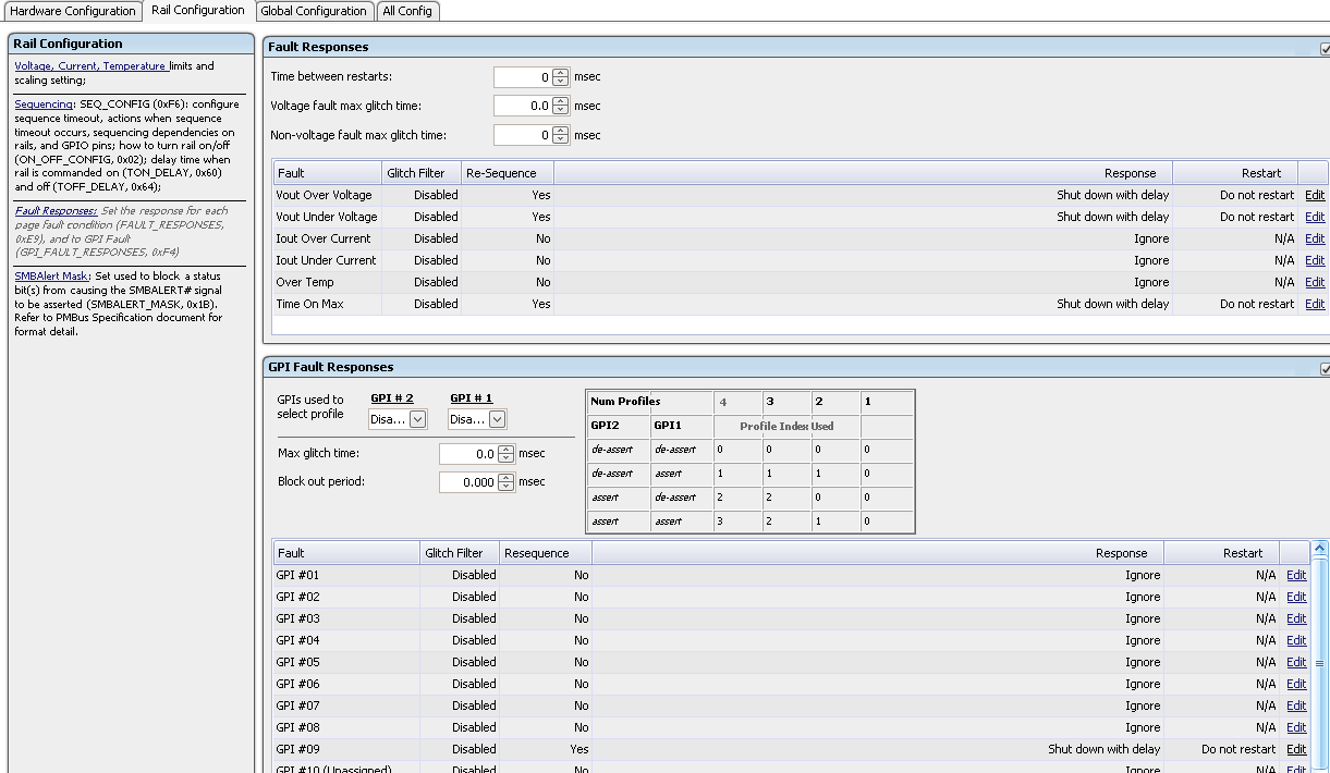

  • Please see my attachment....
    Is this the area you are referring to?
    I don't see a way to configure fault shutdown slaves for a GPI input configured as a fault input... even if I click "Edit" for that GPI.
    Can you elaborate on how to configure this?
  • Hi
    There is no dedicated shutdown slaves for GPI, but the same shutdown slaves of OV/UV apply on GPI as well.
    For example, Rail 2/3/4 are shutdown slave of rail#1. if rail#1 is set to shutdown for its GPI fault response, rail2/3/4 will be off as well along with rail#1.
