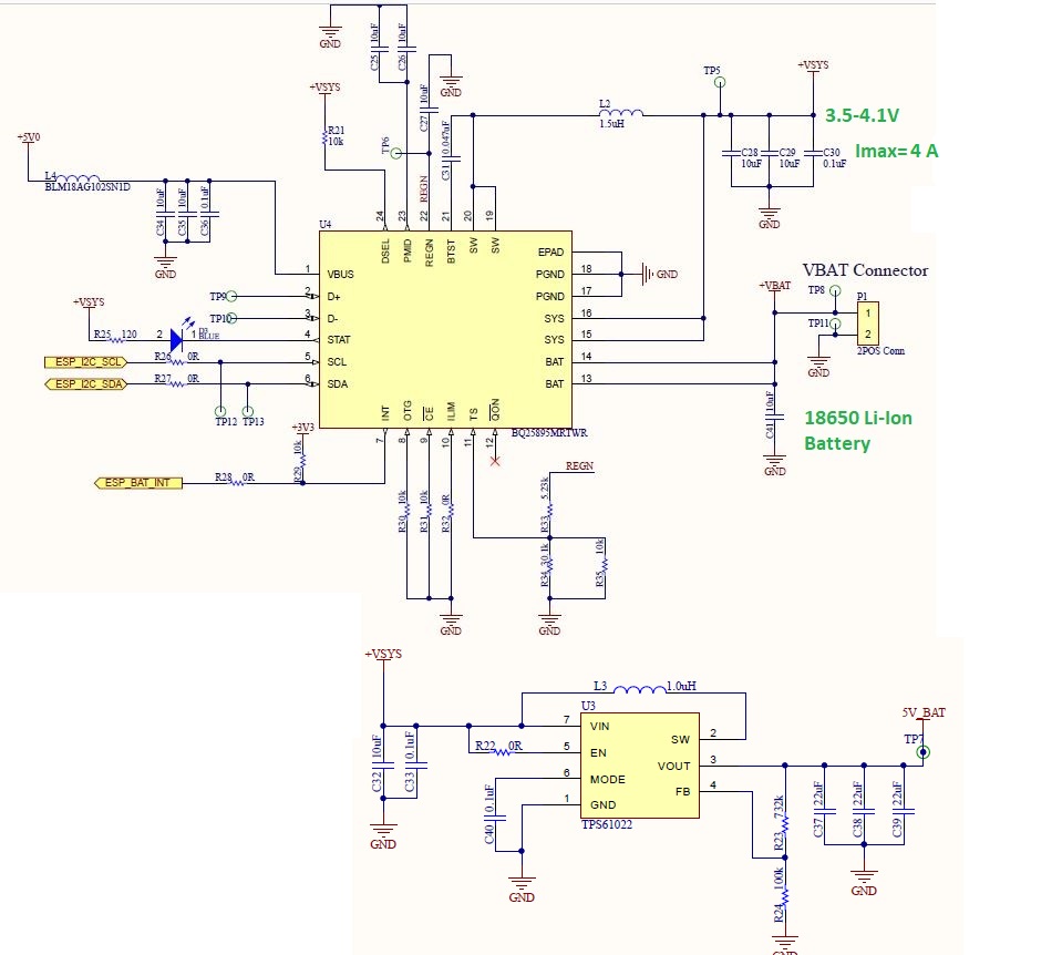

BQ25895M: Battery Charger and Discharge Circuit
Part Number: BQ25895M
Other Parts Discussed in Thread: BQ25895
Our requirements,
Input is 5V from USB Type C or internal 5V converter.
Output is 5V constant & maximum load current is 4A. (As per datasheet, system voltage range is 2.304 to 4.848V. so we are using boost converter in the output of Sys pin.)
Single Cell 18650 Li-Ion Battery 3.6V.
Please review and let me know your comments on our design.
