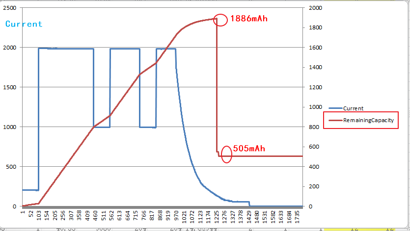

Why does the remaining capacity change from 1886 mAh to 505mAh?
The gauge performs updates periodically during battery cycling, it looks like there was an incorrect calculation.
Can you share the log files from bqStudio and the .gg file for your system when you performed this test?

The log files from my GUI and the .gg file rom bqStudio.fcc.gg.csvLog222.csv
Wyatt Keller:
The .gg file from my golden image.Please check the file for errors.Thanks.
I reviewed your files, the configuration looks correct I couldn't find anything abnormal with your parameters.
Usually with jumps like this it is temperature related or the resistance table has a bad value so when the gauge updates FCC and RemCap it drops very quickly, but both of yours looked okay to me.
Is this error repeatable when performing the same test again?
