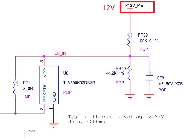

TLV809: TLV809K33 can't work normally
Part Number: TLV809

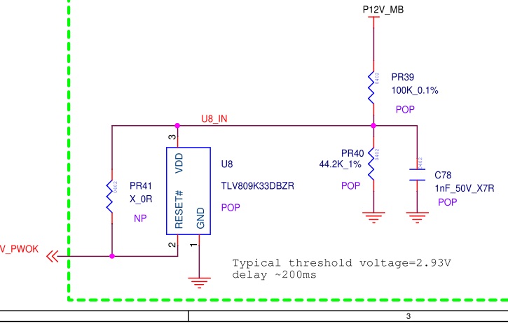

TLV809K33 can't work normally as following picture.
The voltage of P12V_MB is 12V. When i provide 12V to TLV809K33, there is not output on the reset pin.
I measure the voltage on NET: U8_IN is 3.3V.
Could you tell me the root cause?
When i change the value of PR39 and PR40 as below, the schematic has normal output on the reset pin.
Change PR39 to 4.75KΩ
Change PR40 to 1.8KΩ
