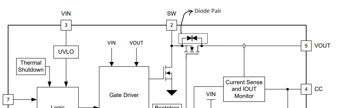

    However, when I measure the output of TPS61235P (boost converter) with its output disabled and battery attached to its input, I observe no voltage. Can this be because the TPS61235P has a blocking diode pair arrangement as described in its block diagram? (below image shows it marked)
    If this is the case then I believe that we cannot use the TPS61235P if we need to use the auto detection circuit or we need to find some other way? Is it correct?
    Sarth
  • Hi, Sarth,
    Yes, you are right. For TPS61235, in shutdown mode, a true disconnection between input and output is implemented. It can prevent current from input to output, or reverse current from output to input.
    In the PMP4451, it is using the TPS61088 for A port, there is no reverse blocking diode within it.
    If you are using the TPS61235,  your understanding is correct.
