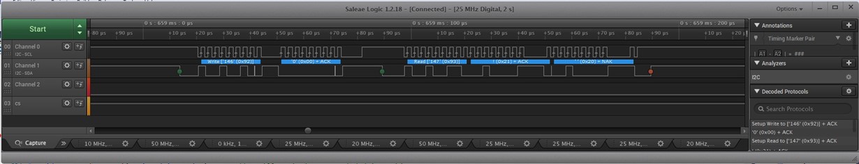

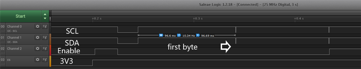

I have made several prototypes with the LP8863 without any problem. Now the first production run is in and I have a problem with the I2C bus.
Of a bigger batch (which I have to test ) the first 4 out of 5 do not function. With correct levels, timing both with and without leds, I get a NACK in return. In the end I replaced the LP8863 and the board works fine.
With a second one, also.
Testing is done with both own SW as via the I2C of the evaluation kit.
Any idea what the cause of the failure can be? Production is done in a professional assembly factory. ( LP8863 AQ1 - 02TG4 - AQYV )
