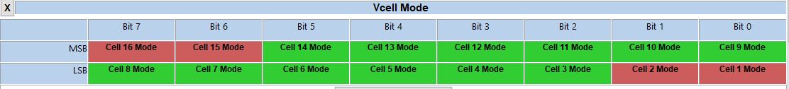

    The value I adjusted the Cell Config to is :0b1100000000000011 -> the upper and lower two cells.
    Aditionally I added a dummy resistor to TS2, and configured TS2 to Cell temp and TS1 to unused.

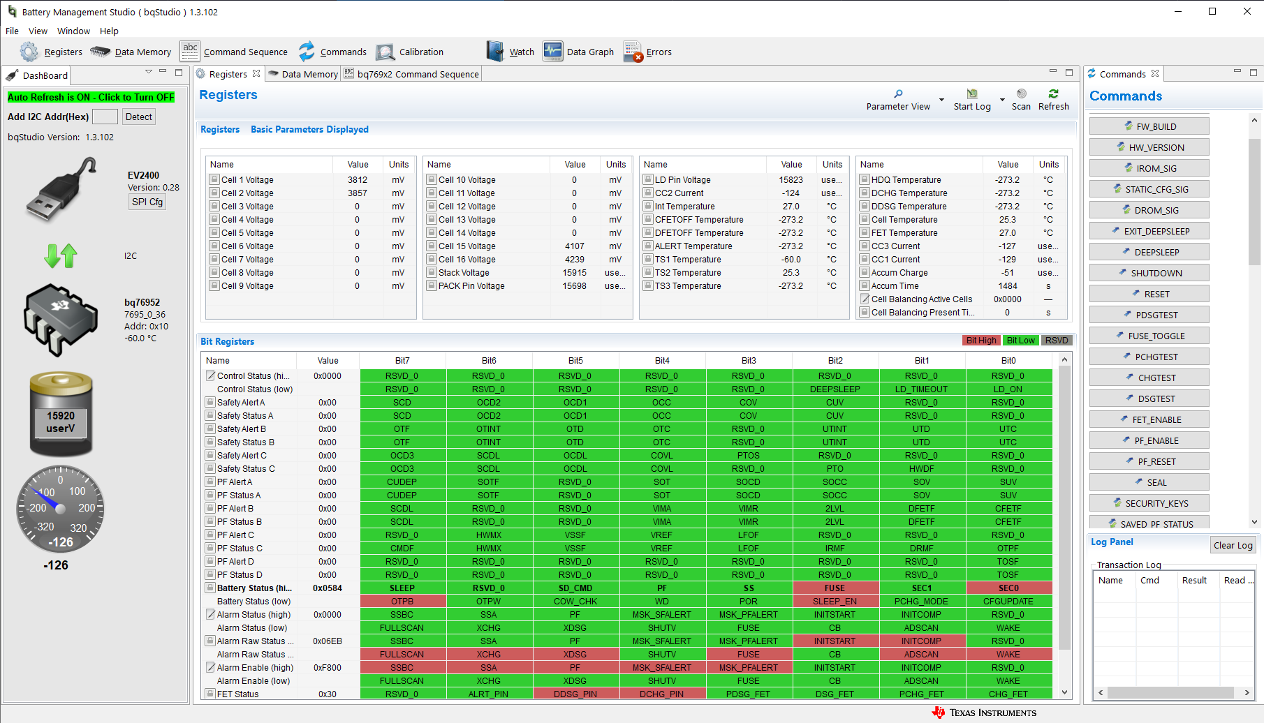

    When I double checked the configuration with the Battery Management Studio, I found that I wrote the Cell Configuration to the wrong address, thats why the balancing couln't work.
    Host controlled balancing does work now. However automatic balancing is not.

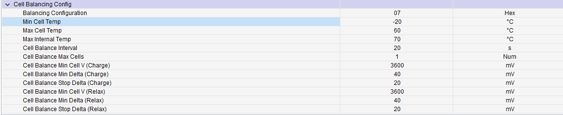

    Could you please take a look into my configuration, to see if something is blocking the automatic balancing?
    And the Configurations :

  • The problem was that the current (-126mA) was lower then the specified discharge current (-100mA) therefor the device was neither in charge, relax or sleep mode.
    -> no automatic balancing.
    So when set the discharge current to (-200mA) it is working.
