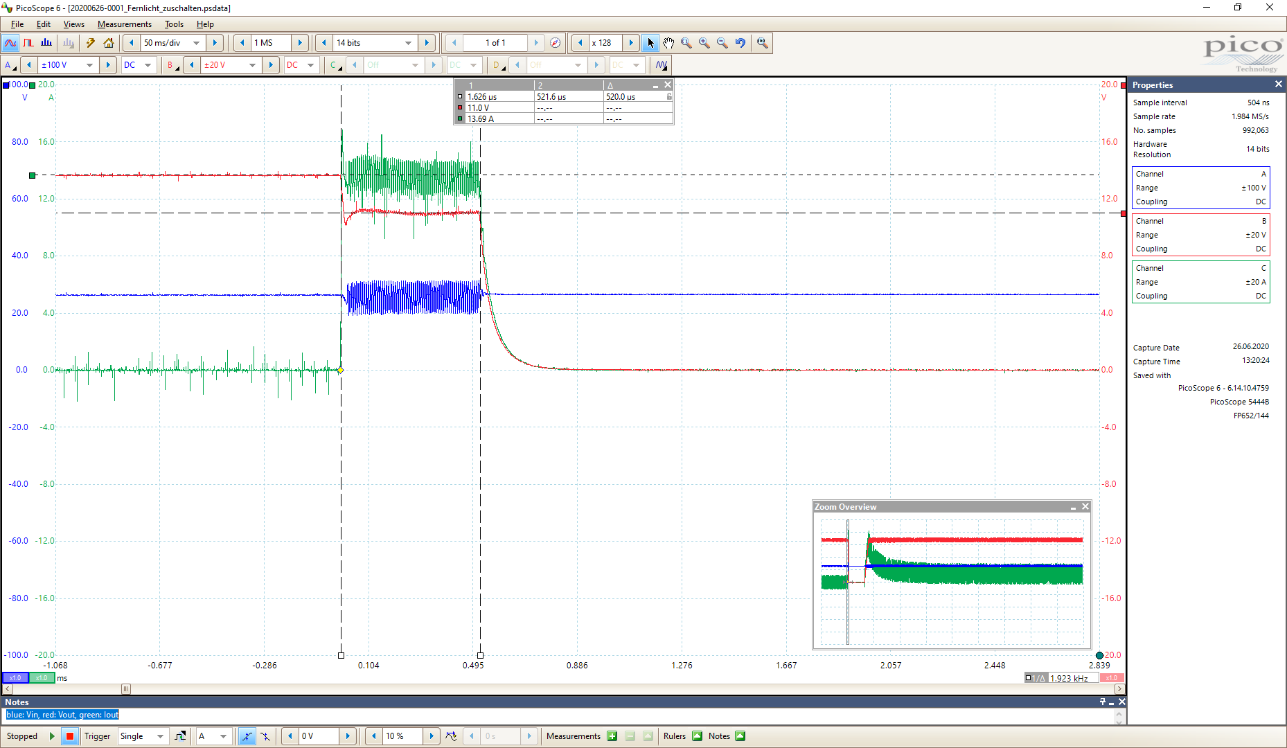

    Yes, I need it for around 100ms, to start up loads like halogen lamps or loads with a high capacitance. The loads are connected during operation of the dc/dc. In the following Image there is the situation as it is at the moment (blue: Vin, red: Vout, green: Iout). After connecting the halogen lamp, the voltage drops from 13.6V to 11.0V and the current is at 13.7A (which I can set). After heating up the halogen lamp, the voltage would rise again after a few dozen ms. But unfortunately the output voltage is set to 0V after 0.5ms.
    So, the solution with the current sense amp and the shunt would work, but I would prefer a solution without a shunt. Also because the current solution is very close to what I need, except for the time.
