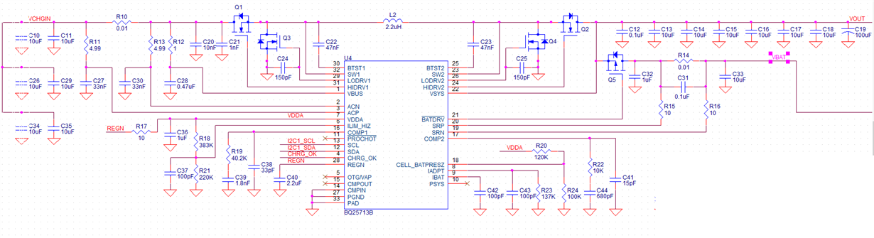

Below you can find my schematics:
Is there any limit for the battery voltage that the charger understands that the battery is full and drops the current to 100mA even though it can still accept 500mA.

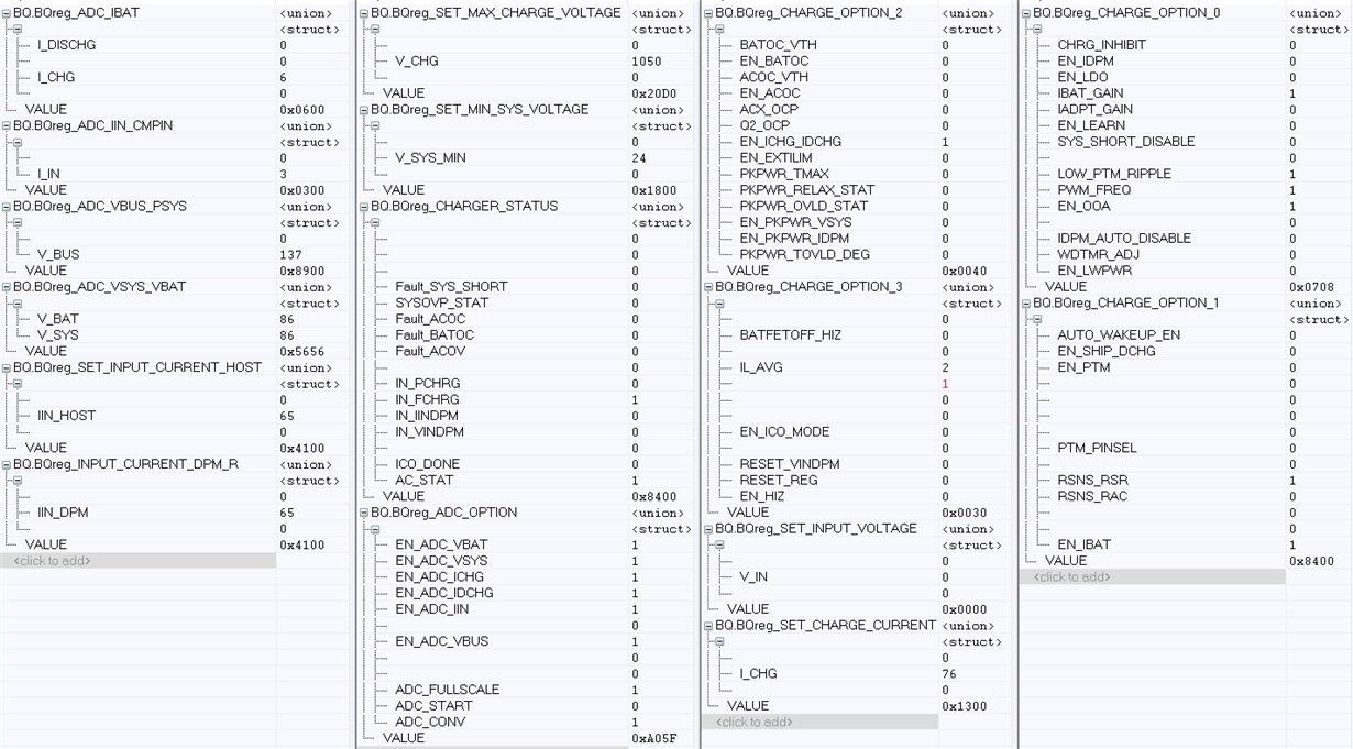

    Below I'm attaching the values of BQ25713 registers when the battery voltage is 8.256 (charging stopped, circuit is battery powered and consuming ~3 mA)
    I observe ADC_IBAT.I_CHG as '1' = 32 mA, from the ammeter connected in series with the battery I read 70 mA of charge current. From SRN I read 8.445 V (8.26 V without charging). From IBAT pin I read 0.025V (I_charge = 0.025V / (16 * 0.02 ohm = 78 mA).

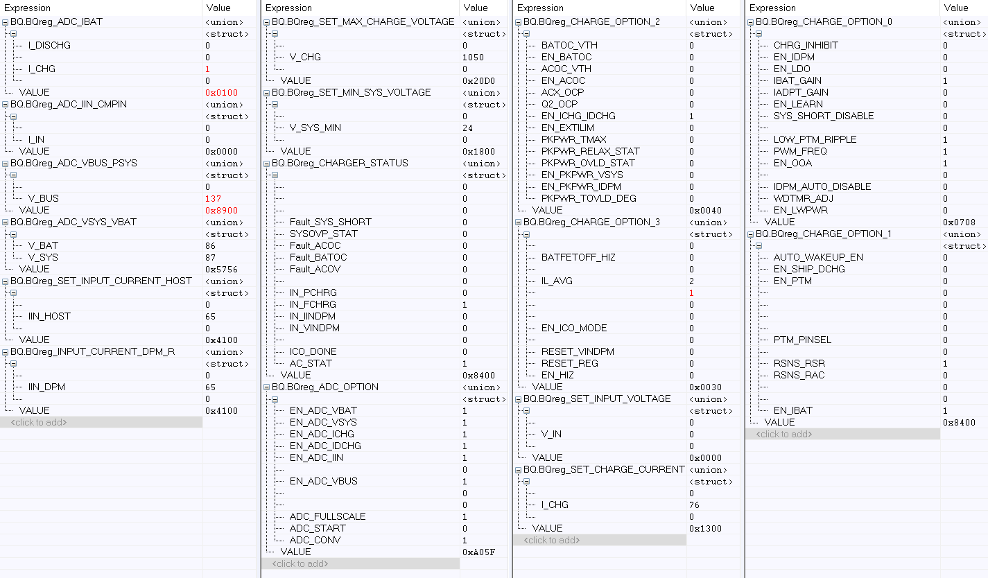

    To get the actual charging current I proceed with the procedure described previously. Below I'm attaching the new register values:
    I observe ADC_IBAT.I_CHG as '6' = 192 mA, from the ammeter connected in series with the battery I read 203 mA of charge current. From SRN I read 8.39 V (8.26 V without charging). From IBAT pin I read 0.062V (I_charge = 0.062V / (16 * 0.02 ohm = 193.7 mA).
  • Hi Dimitriy,
    You mentioned that you have a meter connected in series with the battery. The internal impedance of the meter has impact on the charging profile. Could you check the result without the meter in the loop?
  • Hello Team,
    Yes you were right, without the ammeter in series I can now charge the battery of 8.3 V with 400 mA charge current. Interestingly the ammeter was bloking this current, I have measured its input impedance as 0.4 ohm.
    Thank you very much for the support.
