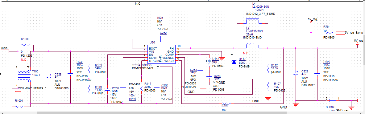

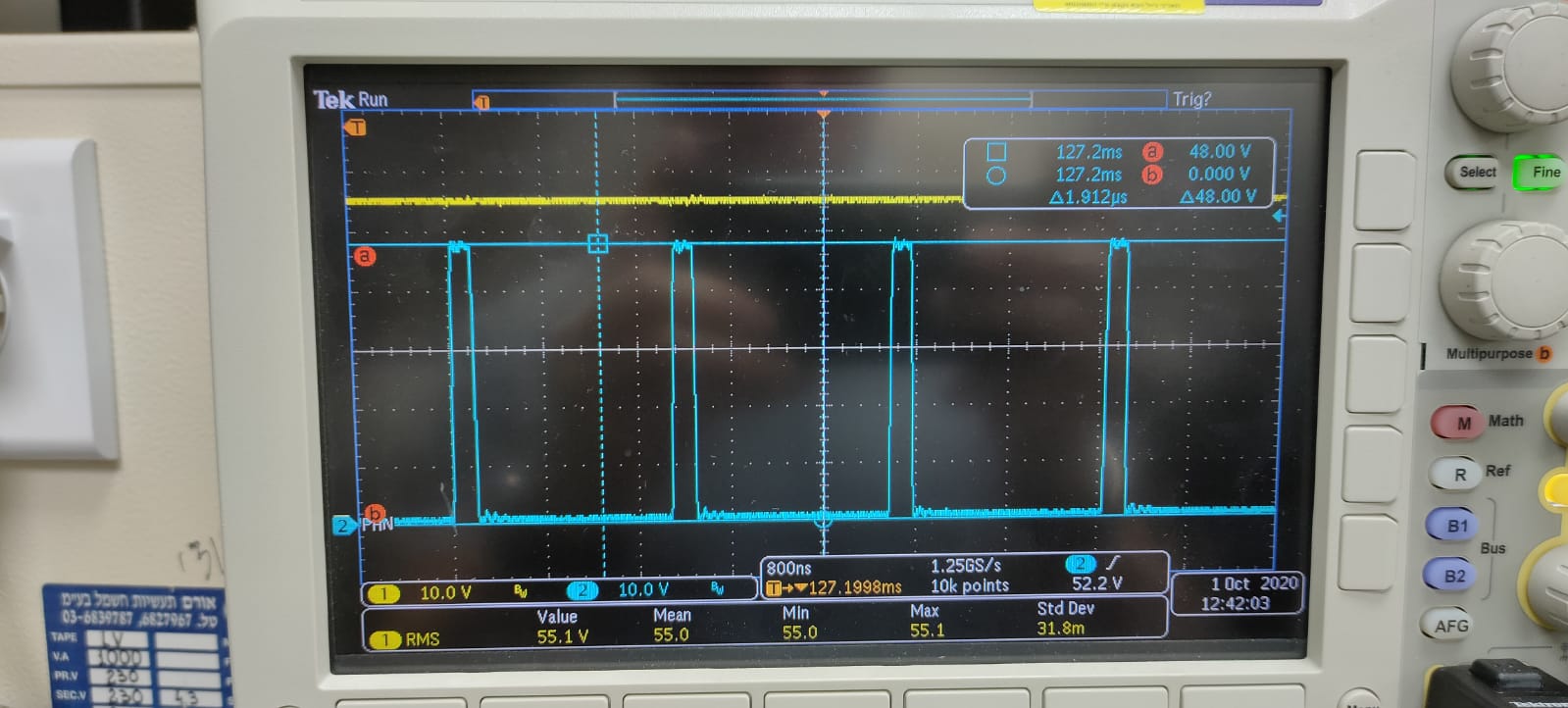

TPS54160: TPS54160
Part Number: TPS54160
hi

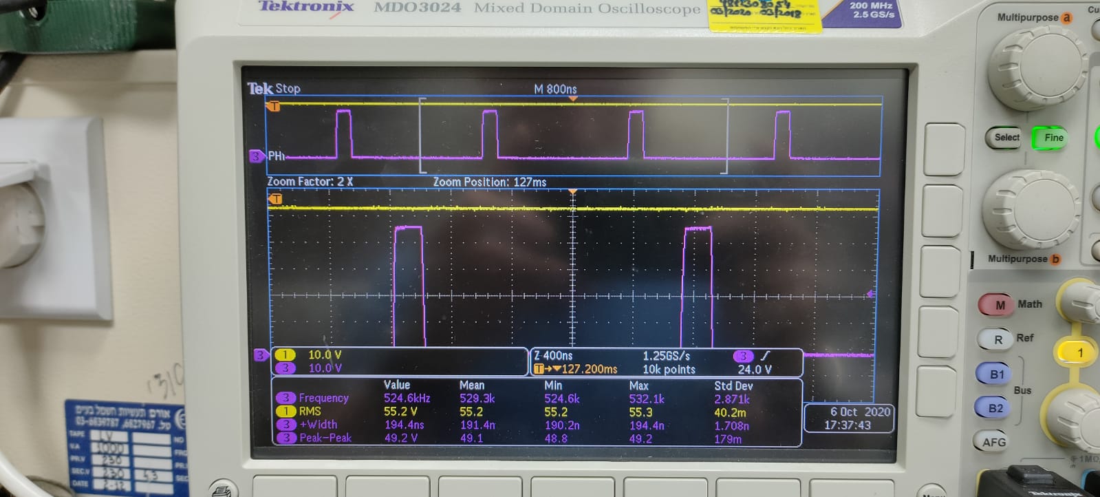

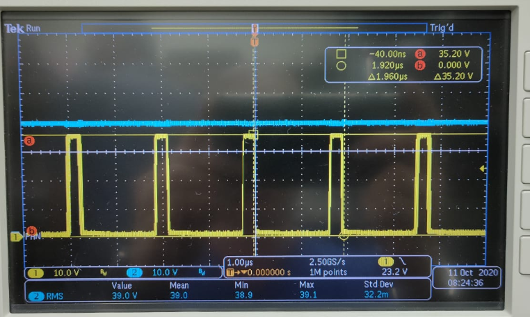

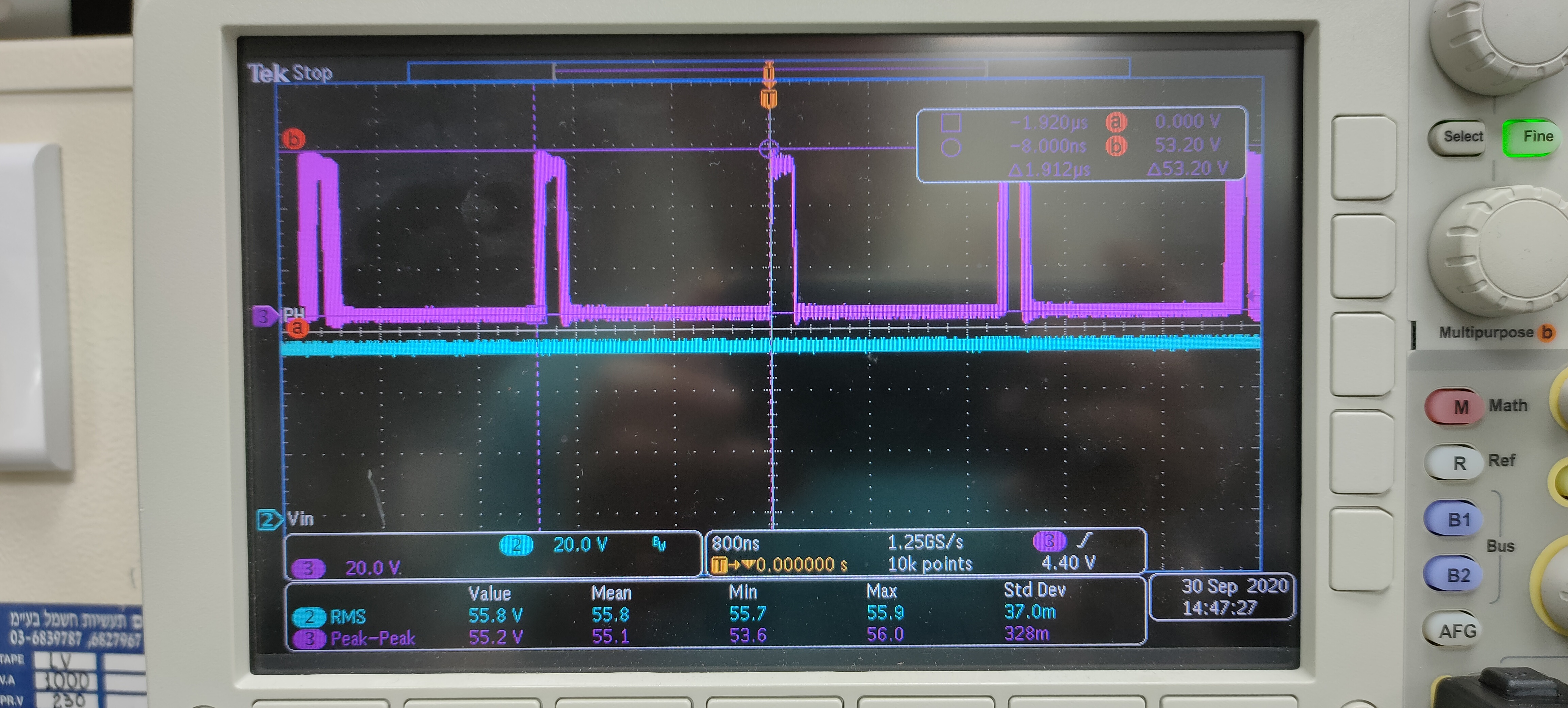

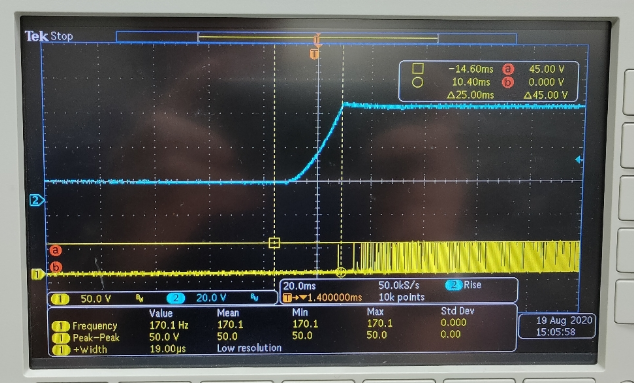

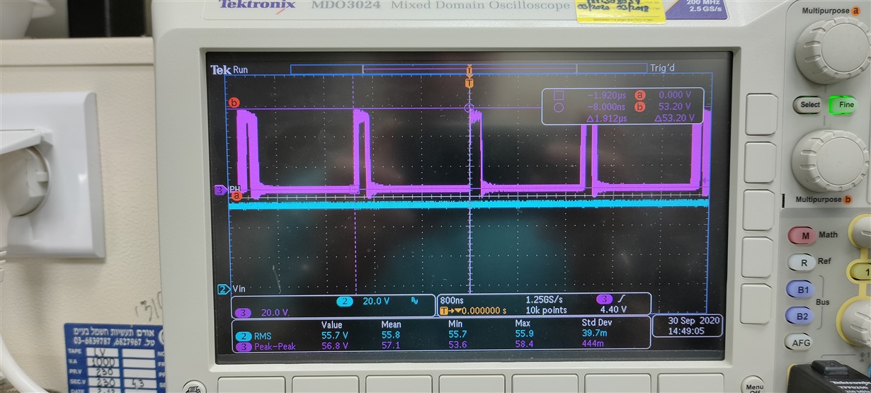

i have the TPS54160 designed as a step-down converter from 55v to 5v using your guide lines as part of bigger system. in the field some units failed and found to have this component (TPS54160) damaged with it's catch diode. could someone look at my design and can think of a reasons it's happen ?
thanks in advanced
itzik
