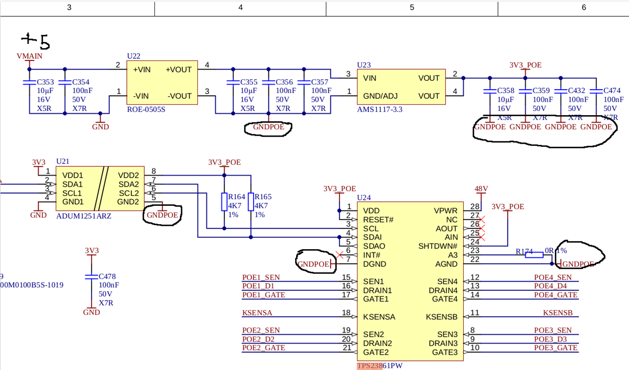

    I can't uderstand why I should supply tps23861 AFTER 48V. In my case I have separated supply
    through ROE-0505s. You can check it on this scheme, also TPS have different grounds.
  • Hi Oleg,
    The comment about the 3V3_POE was only a schematic comment for the PSE.
    This should NOT affect what is going on the TLK part. I have also looked at the schematic and do NOT see a ground connection that could be relating the PSE and the TLK part. Did you try checking on your board directly if they are connected by ohm-ing it out with a multi meter? Maybe the schematic is correct but something on the board itself is incorrect or maybe a wrong component is populated on the TLK circuit?

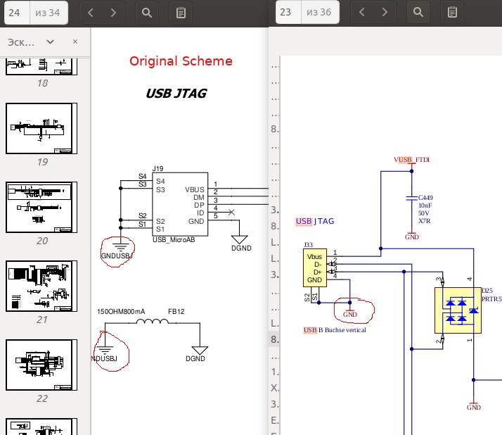

    I found some strange thing....when I connect my Usb cable for debug console in my pc and try to make couple of measurements between groud pad TLK and pins of ethernet cable which connect to DES1016A I have about 70v. I think the problem in  voltage flowing from capacitors which installed on power supply my pc.
    Any way I will replace TLK and try to not connect usb cable. I mean the reason of problem can be lack of isolation. I will chat you about result maybe you will found somethink too.

  • Hi Oleg,
    I agree, there maybe some isolation issue or some grounding maybe to earth ground that causing this behavior. When the USB is connected, it should be connected to earth ground since the connector is metal. Do you know if SGND on your board connects to earth ground? Or are you using shielded ethernet cable as well?
  • Hello Darwin,
    Like I understood I didn't use shielded ethernet cable and I haven't ground connection on my board.
    If you mean USB cable yes it is shielded like 99% usb cables...but I found interesting thing look at the scheme:
    The tupical scheme Power suply pc have a 2 capacitors (filter) and middle point of this filter is connected to case of pc. We have a 220v Input voltage and I am not sure about ground maybe we haven't normal ground in the socket. like you see grounds is united ....Obviously we will have about 1/2 of imput voltage it is aproximatly 100v on a gnd.

    Actually I still misunderstand you but the problem is I no have EVM board only 1 my castom.
    The circuitry for my custom board is similar to the one used on the EVM. With the exception of the transformers which are built into the connector on the EVM and are not shown in the original diagram, in any case, 48 volt power is supplied after the transformer. Thus, the TLK105L is isolated by a transformer. I repeat that there is no such problem with the KSZ9031RN. The problem manifests itself only where TLK105L are installed.
    BR,
    Oleg
  • Hi Oleg, thanks for clarifying. I was originally trying to debug TLK with TPS23861 solution from a PoE prospective since I am the apps engineer for PoE PSE. But if you say another PHY chip operates correctly, then I do NOT believe it is a TPS23861 PoE design issue. My debug comments above was only to really be certain that the PSE hardware design was not the issue (by bypassing it with the EVM which is a known working design).
    My comments on the TLK part are limited since I'm not familiar with the IC. From a PoE prospective, as long as there is isolation from PoE and data, also the data transformer can support power, and the center taps on the data side is configured to the specs of the PHY, the overall design should be okay.
