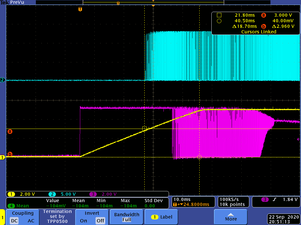

Could you please verify what is UCC2897A startup SS pin threshold? or what is the switching turn-on delay after SS exceeded 2.5V?
Datasheet stated the effective range for SS pin is from 2.5V to 4.5V, but in reality we measured the UCC2897A only start switching after SS pin exceeded 3V, please see waveform below.
We checked the FB pin at beginning was at high level, the switching was determined by the SS pin. This will cause an issue that the controller will issue a first pulse with very high duty and causing the input voltage to drop due to the inrush current.
CH1:SS
CH2 OUT
CH3: FB
Thank you.
