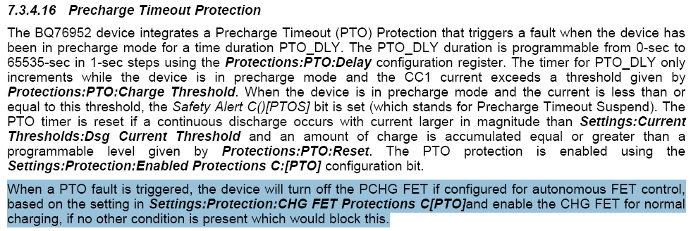

              According to the specification, when the PTO occurs, CHG-FET will be automatically started.
              However, the actual test found that after the CUV, then I made bq76952 trigger the PTO.
              At this time, I found that the battery could not be charged or discharged.
             shouldn't CHG-FET be automatically enabled?
             I don't know if my understanding is correct.
    I think this may be an error in the pre-production version of the datasheet. The new documentation for the device (which should release to ti.com next week) has this for the paragraph you highlighted:
    When a PTO fault is triggered, the device will turn off the PCHG FET if configured for autonomous FET control, based on the setting in Settings:Protection:CHG FET Protections C[PTO]. Precharge mode cannot restart until this fault is cleared by sending the PTO_RECOVER() subcommand.
    So the CHG FET will not be automatically enabled.
