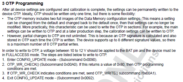

Hi Team,
Except the following two items, what's the necessary for OTP process?
  • Between 10 to 12 V should be applied to the BAT pin
  • Must be in FULLACCESS mode
Customers are thinking to reprogram OTP because we have 8 times. They plan to reprogram after shipped during all cells are attached and just isolate Vbat to apply 10V~12V voltage on BAT. Does it work?
