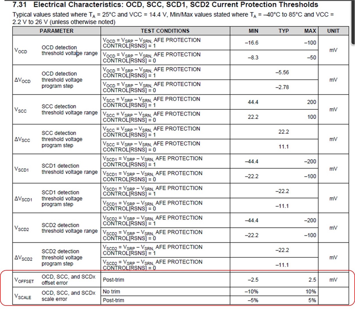

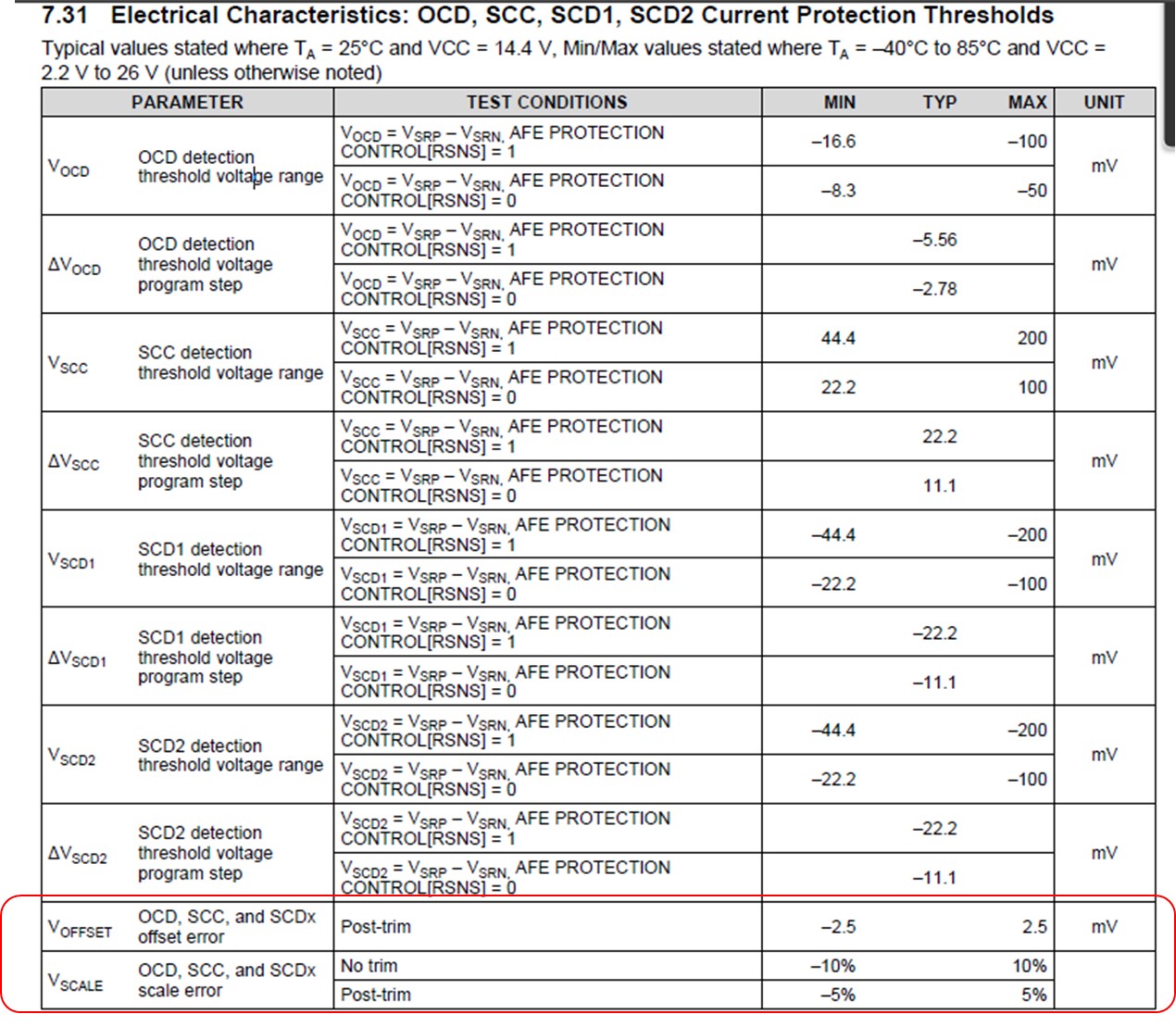

Hello Sir:
We want to know the offset error and scale error of AOLD function.
But I cannot find out it on datasheet.
Does the parameters of Voffset and Vscale can be used for AOLD?
Or there has another parameters can be used.
Please let us know your recommendations.
