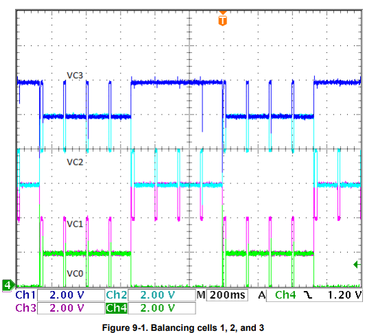

Please let me know how to verify BQ779XX cell balancing functions, is cell balancing happening or not.. testing and verification of cell balancing on bench level.
Devayani Bodar
    To test if cell balancing is working, you may simply monitor the voltage on the cells on a scope when the cell balancing conditions are present. We have a screenshot in our datasheet (see below) that shows how the cells behave during balancing.
