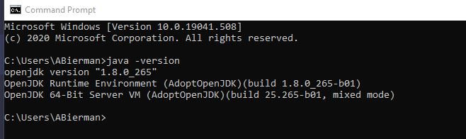

  • Hi Anthony,
    I really appreciate the follow-up. Running a JAVA version check through my command prompt we are at version 1.8.0_265. Here is a snip from the result.  We are getting beyond my knowledge level for what to check for, so if this isn't what you wanted just let me know and I'll get the relevant information, we are curious as to what happened as well and if this is the first time you've heard of this happening. The first time the install happened several programs were running in the background, the second attempt there was nothing else running except this install attempt and windows services.

  • Hi Adam,
    Thanks for the information. I'll see if this information is the main concern. I've installed it to my personal system and have ran the same command as you. The difference at the moment is that you are using the OpenJDK version.
