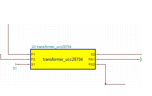

    We are trying to simulate the webench design on Tina TI.
    along the spice model file we found a spice model for transformer and used the same.
    Is this the correct way to connect the transformer?
    are p1,p2 primary side of the transformer
         s1,s2 secondary side and
    Rs2 and Rs2 the auxiliary winding at primary?
    after making connections we are observing that for a 325V DC input( we are simulating from the DC stage after the rectifier and filter)
    and observing that that output of the converter is almost zero.
    Vout is the output of the converter and VF1 is the vdd to ucc28704 IC

  • Hello Harini,
    I am not sure what the issue is that you are having with using a Spice model in Tina for the UCC28704 in Tina.
    I have heard others have had the same issue.
    There is a transient Pspice model for the UCC28704 that should be a good starting point for your design; as well as, a free version of PSPICE that you can download from TI to evaluate it.  You can find the software at the following web link. www.ti.com/.../PSPICE-FOR-TI FOR TI&tisearch=Search-EN-everything
    I would suggest that you down load the free version of PSpice and start your evaluation with the UCC28704 PSpice Transient model.  The PSpice software also has 1 to 2 transformers that you can you use for evaluatoin.

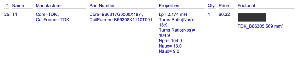

  • Hi Mike,
    Thank-you for the reply.
    in the webench design  document transformer windings  are as follows
    Naux= 13
    Naux= 9
    which one is the main winding and which one is the auxiliary winding at the secondary?
    and where do i find the awg of the wire selected?
    Thank-you
    Warm Regards
    harini krishna
    Naps = Primary to secondary turs ratio = Np/Ns = 104/9
    The second Naux is the secondary winding (9)  and not the aux winding.
    The first Naux is the bias winding.
