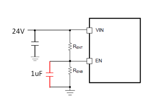

My customer is evaluating TPS560430 and find an issue in power interruption test.
Then they put 1uF capacitance on EN pin like the below figure. Then this problem was solved.
Is there any problem to put a capacitance on EN pin?
