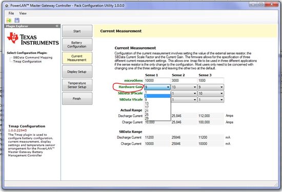

Hello Guys,
I am using a BQ 78PL114S12 with a LiFePO4 (chem 405) 4S/8P 18650 battery pack
Could somebody confirm that, as we see on this screen capture:
 We can move Hardware gain from 9 to 5, in order to increase current measurement discharge from 10 to 20A
Using the Tmap configuration tool
Without changing hardware over current safety data set, for instance Hardware Short Circuit Threshold = 63 (about 30A with a 10 milliohm shun)
Thanks for your help
