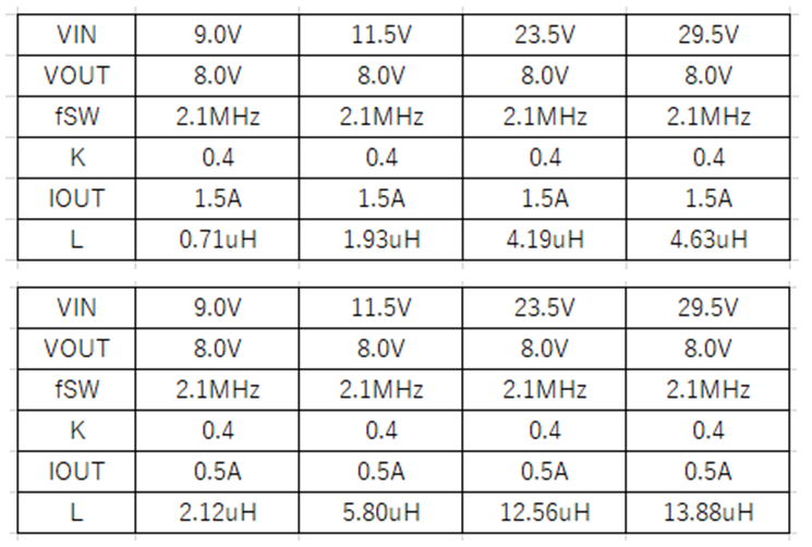

I am considering using the LMR36015-Q1 device.
I would like to ask you about the inductor selection.
The specifications are as follows.
(question 1)
I first calculated the inductor with a permissible current of 1.5A for this device. The results are shown in the figure below.
At this time, is 4.7uH the optimum inductance to select?
(Question 2)
I then calculated the inductance with a minimum value of 0.5A, which is the specification.
At this time, the maximum inductance was 13.88uH.
As shown in the above calculation result, the inductance value has a wide range of choices.
What is the optimum inductance value in my specifications?
(specification)
VIN: 9V-29.5V
VOUT: 8V
IOUT: 0.5Amin, 1.5Amax
