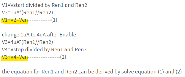

Hello experts,
In this thread, there is description of V1+V2=Ven and V3+V4=Ven.
I'm not clear about this point.
Could you tell me more details?
Thanks and best regards,
Ryo Akashi
  • Hi Ryo,
    For the details behind (1) and (2) needs to check with previous author Andy.
    Key points here are before device Enable, pull up current is 1uA; after device Enable, pull up current is 4uA. So we can have the equations:
    (Vstart - Ven)/Ren1 + 1uA = Ven/Ren2 -----------(a)
    (Vstop-Ven)/Ren1 + 4uA=Ven/Ren2 ---------(b)
    We can get Ren1 and Ren2 by solving above two equations.
