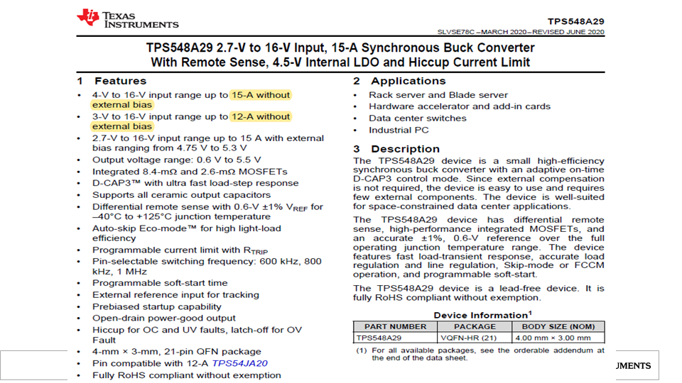

Datasheet show: 4-V to 16-V input range up to 15-A without external bias and 3-V to 16-V input range up to 12-A without external bias. why does the input voltage cause the output current  to change in different ranges? Could  you help me explain the problem? Thanks.

       Without external bias, the Vin is supplying the internal LDO which is used to drive the MOSFETs using the gate driver. A lower Vin, means a lower LDO voltage and thus lower gate drive. This means that the Rdson of the FETs could be higher and the lower current ensures that the FETs can handle the current at this Rdson.

    Since the Gate Drive voltage for the TPS548A29 is derived from the input voltage when no external bias voltage is provided, the Rdson of the power FETs increases, reducing the over-current trip threshold and the range of application currents the device can support.  As a result, if an input voltage less than 4V will be supported, the load current should be limited to less than 12A.
    That is why, when an external bias of 4.75 - 5.3V is provided to support this gate drive and keep the MOSFETs fully enhanced, the rated load current is equal across the full range of load currents.
