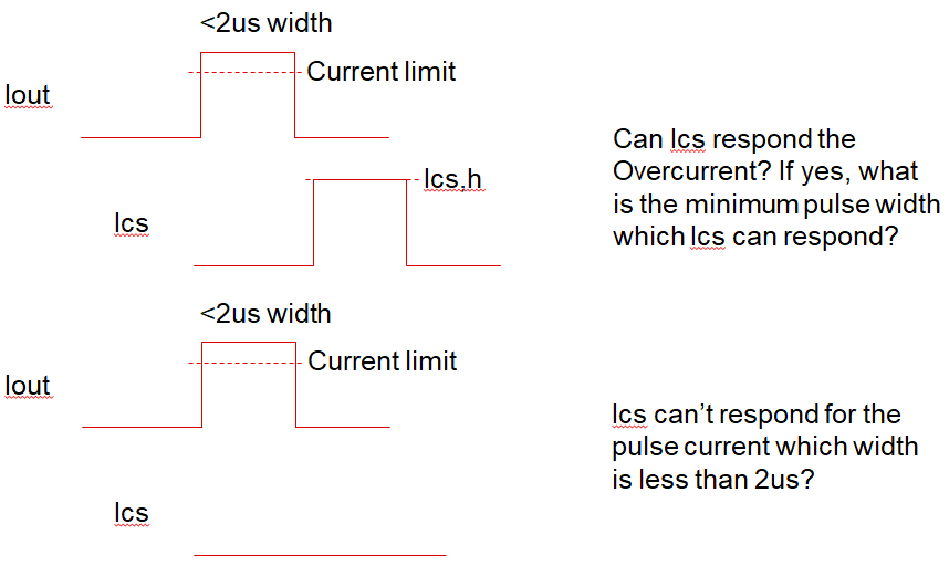

hello Team,
Thanks for your support.
Q. Do you have delay time from reaching current limit to output Vcs,H level on CS pin? Customer want to know the min,typ,max value of that.
Q. The CS pin can output Vcs,H in the off state if the device detect Open load or Short to Battery.  Customer does not need to distinguish open load from short to battery. In that case, Customer doesn't need the pull up/down resistor such as Fig36, Fig47. Is my understanding correct?
